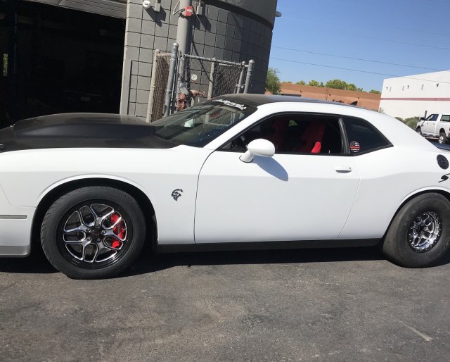

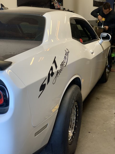

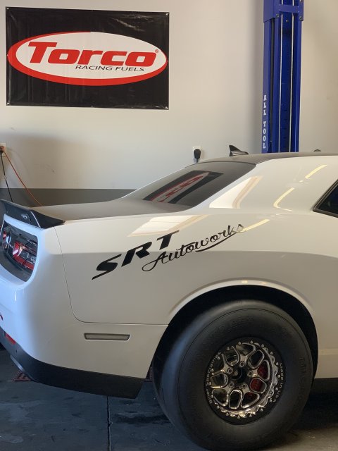

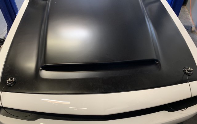

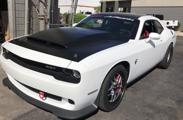

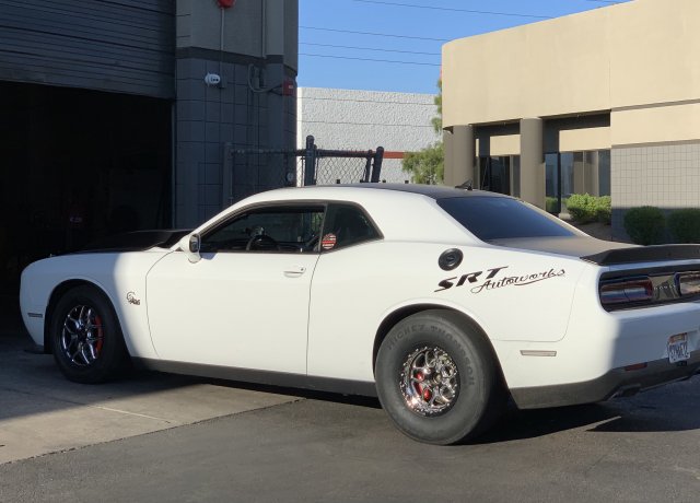

Haha. Yeah I hardly remember doing that years ago. Marc said he would pass along some dates when the time comes. Definitely be a good time. Couple of today’s pics. Got the hood pinned and the rear wheels on and clearanced. One more trip to the dyno with the race fuel and she’s ready to go. BED63BDD-69F1-4ACD-9F50-32930023131C.jpeg 1F455815-41D6-457D-95D3-410022B78E7F.jpeg 2490EE03-3A8D-4764-B6F8-E1EC4B74D574.jpeg

Haha. Yeah I hardly remember doing that years ago. Marc said he would pass along some dates when the time comes. Definitely be a good time. Couple of today’s pics. Got the hood pinned and the rear wheels on and clearanced. One more trip to the dyno with the race fuel and she’s ready to go. View attachment 3639 View attachment 3640 View attachment 3641
Marc your car looks insane good luck this weekend

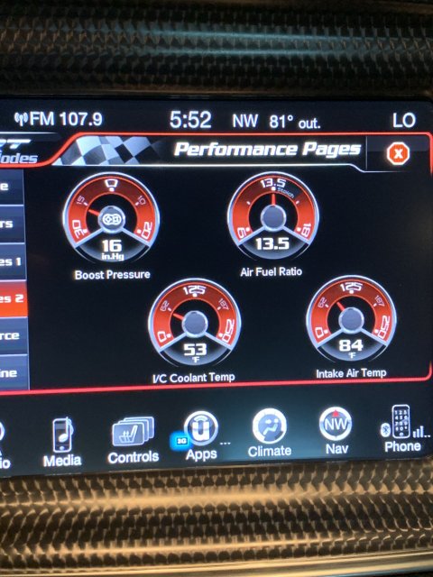

Phil... while I got you on the line. A question on what you think about this. We’ve been playing with the chiller. We’ve got it to where we think it’s about as good as it going to get. We haven’t insulated the lines yet but We will be doing that next. The actual temp of the coolant in the tank is down to 40 degrees and that’s with the tank at half full. So 3.5 gallons. Probably another one plus gallons in the system? I’m thinking at Gila Bend of topping the tank up to the full 7 gallons with ice before each run with the half tank already at these temps will give us the volume to make the full half mile with enough to keep the IAT down for the whole pass. What do you think. Any downside to doing that? FD82D5CC-D25A-4FF9-A1E5-4A142AEBC24E.jpeg

Phil... while I got you on the line. A question on what you think about this. We’ve been playing with the chiller. We’ve got it to where we think it’s about as good as it going to get. We haven’t insulated the lines yet but We will be doing that next. The actual temp of the coolant in the tank is down to 40 degrees and that’s with the tank at half full. So 3.5 gallons. Probably another one plus gallons in the system? I’m thinking at Gila Bend of topping the tank up to the full 7 gallons with ice before each run with the half tank already at these temps will give us the volume to make the full half mile with enough to keep the IAT down for the whole pass. What do you think. Any downside to doing that? View attachment 3643
No down side I think. I would fill the tank up all the way like you said.
If your racing for both days. I would experiment with full capacity and then half tank capacity on the second day and check the data logs.
Another thing I need to do and probably you as well, is completely drain the system and actually measure how much fluid is in the entire system. Would like to know the exact capacity.

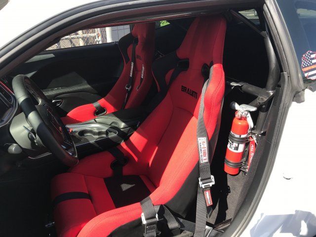

All final adjustments and massaging is done. Time to take her out on the half mile on Sunday and see how she likes it. Got my new seats in and they are perfect. D941E6BE-42A4-46CA-8654-77FC52747DFA.jpeg E219F7AC-3B43-4F89-A631-7519AB0A2DFE.jpeg F9F263E7-4B1D-4213-A4E5-A31B28162C77.jpeg
