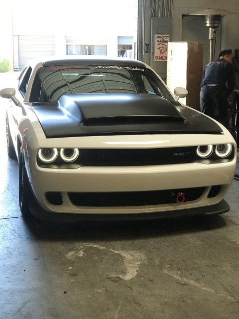

Haha. Yes they are. And as it turns out..... a bit of a problem. The common rib beat down is not going to do it with these chubby fellows. There is going to be a much more invasive surgery required to get those things to fit. All in the same area but more aggressive. So stay tuned. It’s going to be a little more than what probably anybody else is going to want to do, but... that’s what I’m here for. 😝. On the up side..... took it for about a 10 mile drive in the 105 degree heat and she was like Godzilla on a leash. I lowered the IC coolant volume down to exactly half in the ice box. That’s about 3.5 gallons. After about 20 minutes the gauge was at 62 degrees. Did a actual temp check of the coolant in the box and it was 49 degrees (actually felt like ice water when I put my hand in it). So... the interchiller is working! We are going to insulate the lines and play with the charge level some, but it looks like we’re getting some encouraging results. Going to install some more files for drivability tomorrow morning and we’re looking at the dyno next week. C2984E84-1895-4D60-A932-C8F98FB7323D.jpeg B825BF31-A366-487B-BC08-2626AED94C69.jpeg

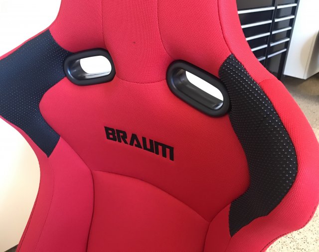

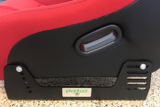

Got my new seats today. I decided that as nice as my black leather Braum’s are... I want a fixed seat for safety at the level we’re shooting for. At a total weight of 23 lbs, this should do the trick and still be comfortable for the street. 7F97C7B4-489A-4C13-A4FC-EF9E90B63788.jpeg 6B22F9DA-579F-4A92-9A66-B154D1712595.jpeg 9D2301E4-386E-4BBB-AB63-7F42BA991C33.jpeg FECA8B54-58D0-4BB2-8D2F-B16C728875F9.jpeg 4823301D-B4FD-463D-888D-1251769E579E.jpeg 01FAE513-55F8-4508-9299-8F3D9914DFD1.jpeg
