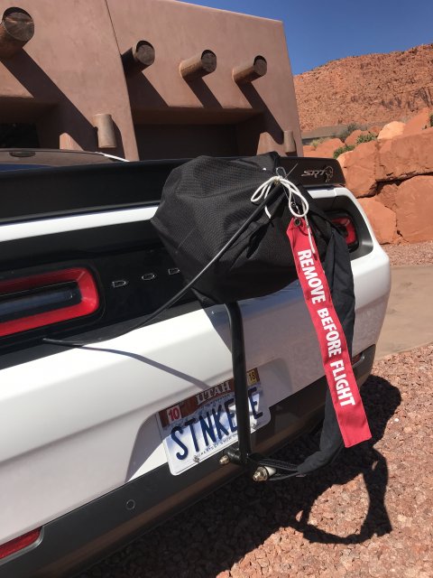

Beyond the cage there are other requirements, including a rear exterior electrical shut off and a parachute if finish line speeds exceed 150mph (they will)...... 226ACC7E-ED23-41AD-ACD0-800312391C40.jpeg 2D549BB2-0DE1-45FF-8B91-F164BE36CEB4.jpeg 676359A0-F0E4-4B46-AE5F-A23C134F9E78.jpeg
