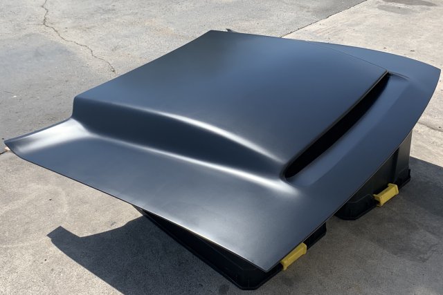

Yes. I wanted the CF version but they have to be ordered thru Anderson. I called and they said they make those by order and I would be looking at 3 to 4 months by the time it got placed into their production schedule. This thing will be on the track way before then so that wasn’t a option. We just decided that cutting the hood wasn’t going to give us what we want and made the decision to go with one of these. The fiberglass was in stock and I purchased it direct from Kenne Bell. I got it in a week. It will look good once it’s wrapped to match the roof.
Wow that's a bit of a wait . I'm sure the kenne bell one is pretty awesome . Can't wait to see it on the car .

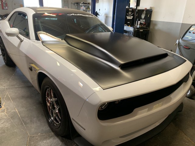

Now that is a great job. No lie. You mind if I ask what they charged you? If you do, I completely understand.
Don’t know. Shop had it done. It’ll be reasonable or they wouldn’t have had them do it. Turned out good with lots of room over the Whipple to get the heat out. F4433945-5D84-42CC-B745-04D352A3293F.jpeg 9E383A5C-52C2-460A-BE4F-61924CDF543D.jpeg

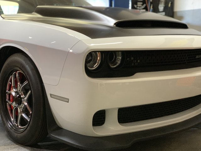

It is amazingly quiet at idle. I have a feeling that at WOT it will be a different story but that’s going to wait a little while until we get on the dyno. Other than tuning the only stuff left to do is get the rear tires mounted and on the car to check fit and get the new hood on. That came in and is being wrapped today. View attachment 1652
Nice. $900 is a pretty fair price in this day and age.

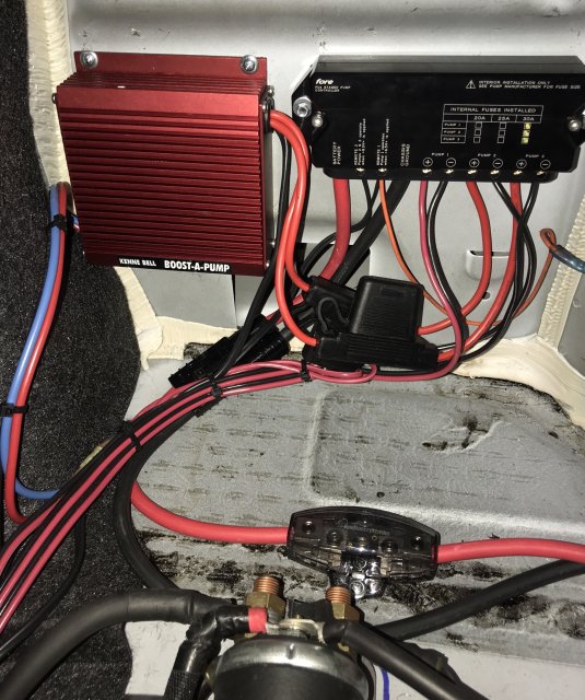

Ok! I’m back at the shop and mounting those big M/T Radial Pros today to see how they’re going to fit. I got the interior back in the car and got a video sound clip yesterday after I arrived. If there are any interweb genius’s that can post video here..... I can send it to you. It sounds pretty badass to say the least. I have one pic to add before I head out to wrestle those tires. Here’s the new electrical for the fuel pumps, including the dual (Demon) BAP. 95633859-4FA9-4FE5-A4A2-3E4097757E0F.jpeg

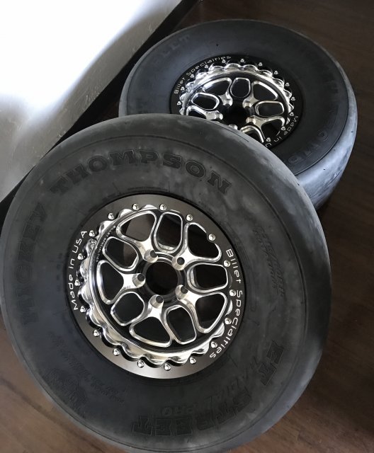

Woohoo! Off to the tire shop for balance. Jeeez they’re big!! 89068FC4-1A9E-48C4-BA4C-46D7E7FBAEBF.jpeg
