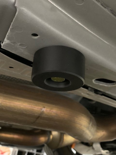

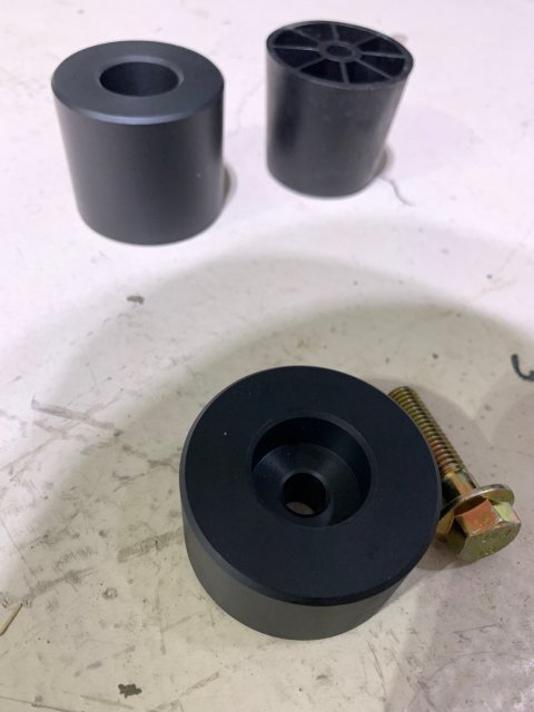

After registering for the No Fly Zone (standing half mile event) yesterday I figured it was as good a time as any to knock out a few odds and ends in preparation for that.
Found out about the Lift Pad Pros here and figured they were mandatory considering that (1) there's no such front jack pad, (2) the front is pre-threaded for one anyway and (3) the factory rear jack pad is complete garbage.

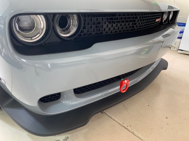

I also needed a tow hook to pass tech so I finally got around to installing the ZL1 addons piece that I bought a while back.
https://zl1addons.com/collections/c...cts/challenger-15-21-premium-stealth-tow-hook
I initially was going to install it from underneath but I didn't have a right angle drill handy, and after watching this video realized that removing the front fascia is pretty easy and straightforward:
I managed to snap off one of the four pins (they're not fasteners/Christmas trees as they don't provide any tension to the mounting hole) on the fascia which was easily fixed with the Loc-Tite plastic-specific super glue I picked up from Ace the other day. I figured I'd grab that instead of stealing my wife's baking soda as a catalyst and it worked great. Apply the activator to both surfaces, wait a minute, apply the glue to one surface and hold in place for 30 seconds. Done; good as new and no issues reinstalling a few minutes later.
I guess the grille on the Chargers is large enough to accommodate the shaft of the tow hook (phrasing!) but no such luck on the Challenger. I had to remove a very small portion of it which was easy with a pair of side cutters. Happy with the finally result:
I wanted an offset and not centered mounting position. The picture makes it look a little goofy but it's offset as much as possible and is right next to the brake cooling duct.

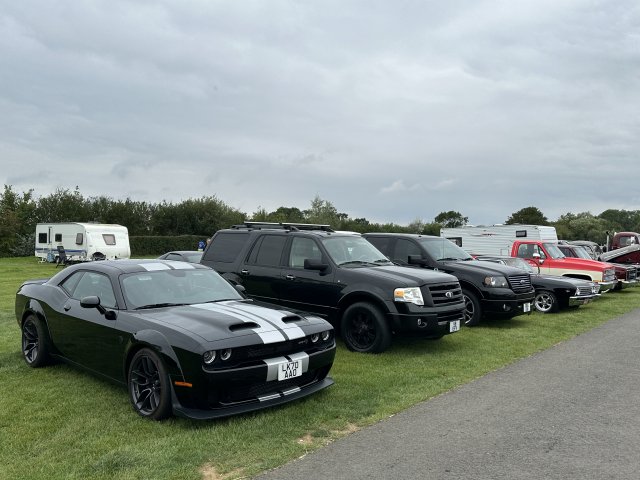

Gave the car a quick wash before an American show, its about an hour away so had to get up a early. It's quite a good one as you can just turn up and they let you in anytime with driver for free which I think it encourages turn out.
Bit of interest in the car and managed to chat with a few people including a chap with a black HC Charger who bought from the same place as me.
Looking at the photo I must try and get the stickers off the sun visors. I think the Canadian ones are stuck over the top of the US ones, perhaps peel the first and see what I've got and resort to exact cut black vinyl over that. I think I might get some smoke film for over the side markers too.

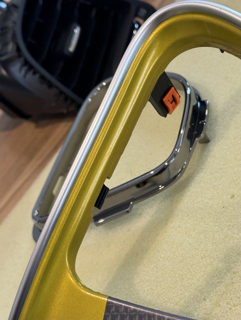

Postie arrived with some 3M knifeless tape so just quickly tried a small section on the engine turned plastic dash piece. Never wrapped anything but seems like it'll work although I'm far from confident about doing the top bit of the binnacle above the speedo. I've got 3M gloss black, the yellow is just a sample bit from my TRX. Will have to find some reading glasses before I tackle it for real :geek:

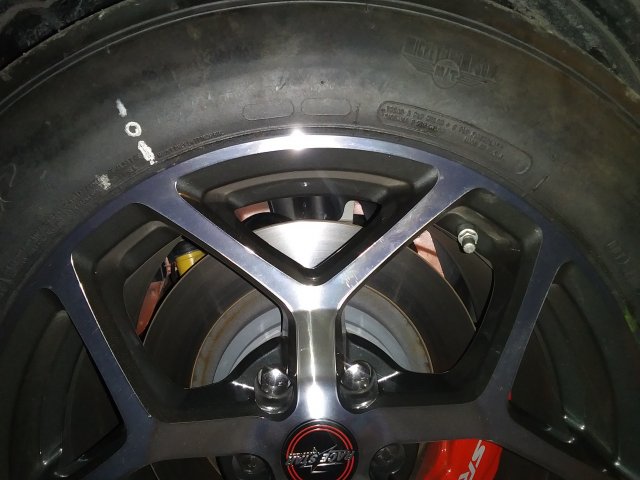

I remounted my MT ET Street R’s on new wheels. I cleaned the wheel bead area with laquer thinner, the dealer said they would clean the bead prior to mounting. When I picked them up 2 weeks ago I could see sealer on the bead, I did not expect that, he said It'd help them stick.
Well, after 3 runs last night, one slipped about 45deg, the other almost 90.
A lot of you guys are very experienced with this, what is the proper way to mount a DR?
Looks great.
A heat gun is your friend.

I just don't think there is any way to avoid the tires slipping on the wheel. Well Weld beadlocks, but they sure are $$$

Some have used balancing beads with success or go with beadlocks.

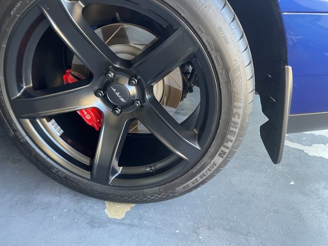

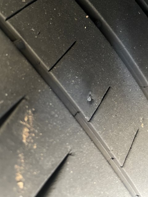

Well that was a pointy pebble jammed deep into the tread on my rear tire. Took it to the tire place just in case, there was no leak but they checked the tire to be sure. Had to re-mount it and they did not have black wheel weights. I’m crying a little on the inside :(
Testor's model paint maybe?
