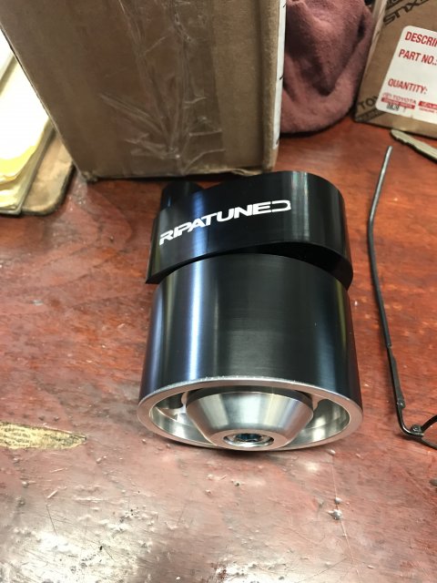

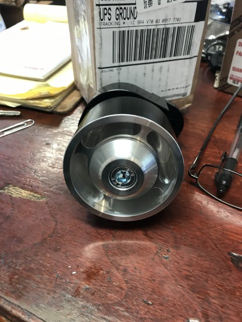

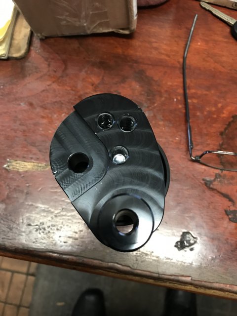

Adjustable tba idler pulley came in today it’s purdy
7A7707A6-96F5-4776-B426-491940ACE300.jpeg 7A7707A6-96F5-4776-B426-491940ACE300.jpeg 6F432C72-D355-4535-A43C-CD9770B0D17B.jpeg B2A88A57-0803-4555-A6B2-06817685B39A.jpeg
