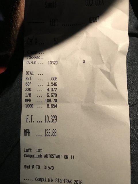

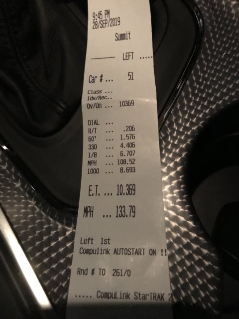

These are from last night my 60 foot times are better and the suspension was stuck in sport mode ,can someone guess as to why it was stuck in sport??? FEEDF7BA-BF69-42B7-A9B3-542FB1BB55B4.jpeg AC1AEE61-A2E2-4AC3-891E-B527A4649B81.jpeg

Soooooo close to 9’s...😳😮🤭🤪. What tire you on?

17 inch race stars with mickey Thompson street etr 345/17

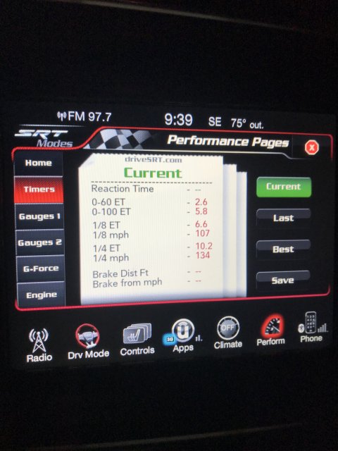

So who is more accurate the car or the track ??? FC44270E-6B75-4EC7-AE50-F847342D4562.jpeg

Guessing your cat is a WB!?You on a 50,60 tire? Just curious. This is a learning process for me.

Nice passes , good job. 10.32 is getting it done. What was the DA that night ?.. The track time slip should be accurate. Thanks for boosting my ego, lol, but like Hpindy said & you know there's a lot of factors on et's , for 1 when I ran my 10.46 it was in 300 DA last April , I ran 10.57 in 2500 DA this summer after some changes, second have you reduced weight ? …. I do pull my seats & trunk stuff most the time but not always , it depends on if I'm comparing 1 mod to another & how it was the last time.
Your doing real good & it's gonna get even better !
Not sure why it would stick in sport mode ? never heard of that , maybe something with tune ? is it still stuck ?

It was stuck in sport because the shock wire had rubbed the inner left rear wheel, I repaired it yesterday

I was going to guess that ........ It happened to me too lol

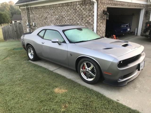

Here’s my car waiting to go to the track again in I think three weeks before the track let’s us nobody’s race again E5CF40C9-3FD0-4F45-803C-A02B06287E6D.jpeg

The DA was 1700 and there was no prep drag racing so I only got two passes that it hooked
