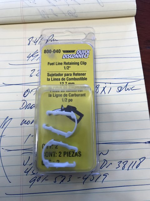

I deleted the file line clip thread because mine came off on me today thankfully didn’t hurt anything I went to the shop and fabricated a clip myself that actually works better but I’m going to try another option this week I’ll update when I find out
Just an update this is the correct part we need for our cars
Heads up 4 parts stores here in town did not carry it I had to special order to get it so be prepared if you ever have to replace it
Man , you are having the worst luck with this fuel pump, line & clip.

I think I found the actual clip that will be the fix , I will have it in next week but the clip I fabricated today worked out very nicely the problem with the 5/8 dorman part# 800-041 is it’s to big I believe our actual line size from measuring the fuel pump where the pressure line goes on is a 1/2 so I ordered dorman part # 800-040

new clip installed proper size I hope my fuel pump days are done,,i tested to 100 psi of pressure and it held fine :)
Lets hope so , I know your ready to move to the next project o_O
