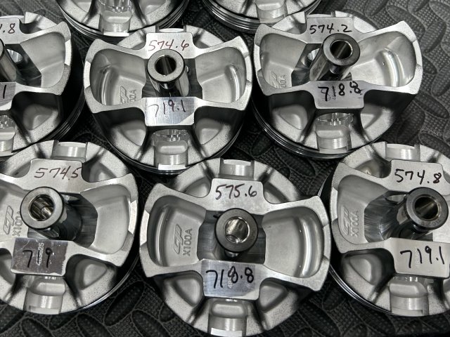

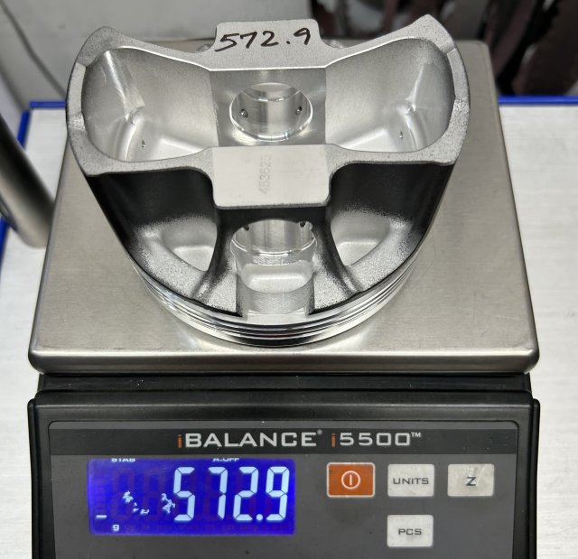

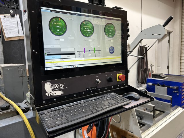

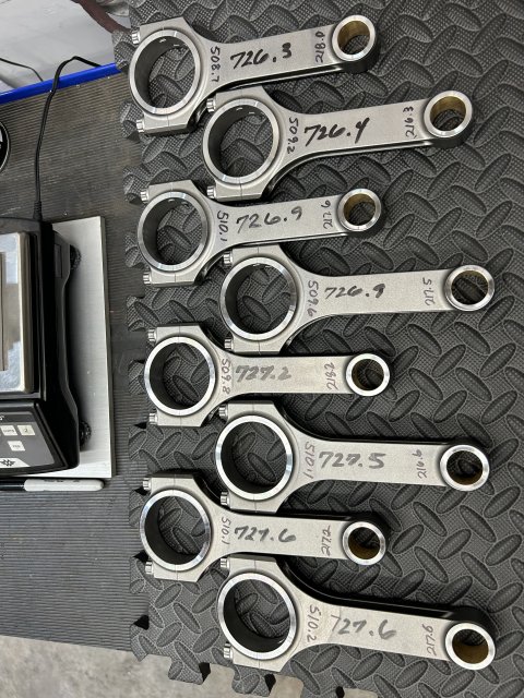

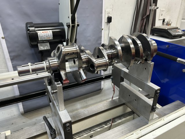

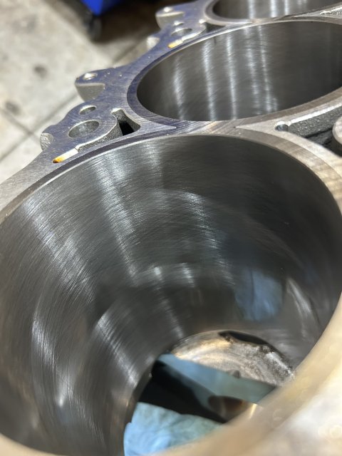

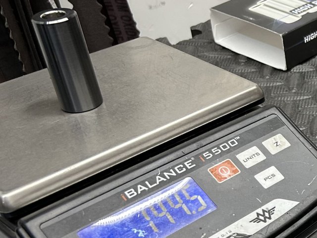

Building an engine capable of spinning 10,000rpm (not going there.. but) takes a lot of work. Weighing and then matching the moving parts… 😵‍💫 We’re talking tenths of a gram. Crank is balanced, block is clean and on the stand and finishing up the rotating assembly. Bearings are next. IMG_8168.jpeg IMG_8165.jpeg IMG_8173.jpeg IMG_8328.jpeg IMG_8329.jpeg IMG_8334.jpeg IMG_8333.jpeg IMG_8252.jpeg

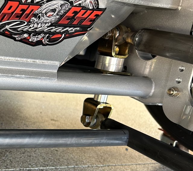

Thread Starter #1,765

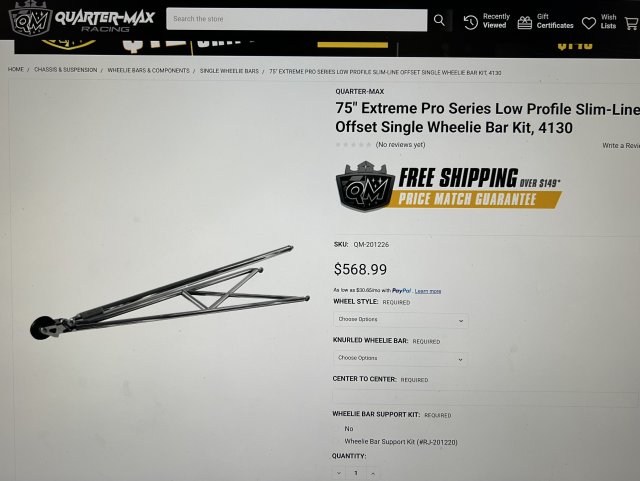

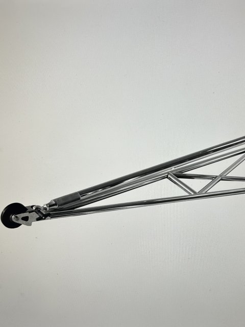

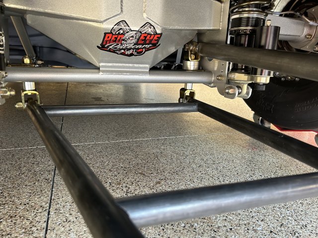

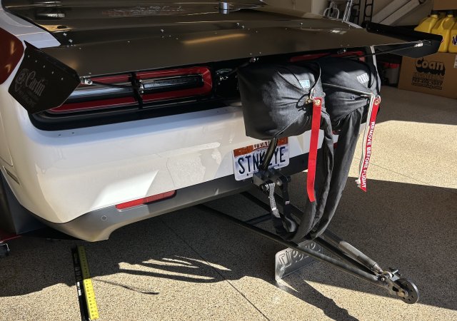

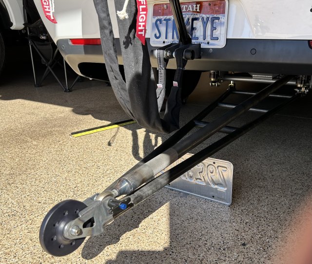

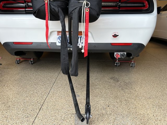

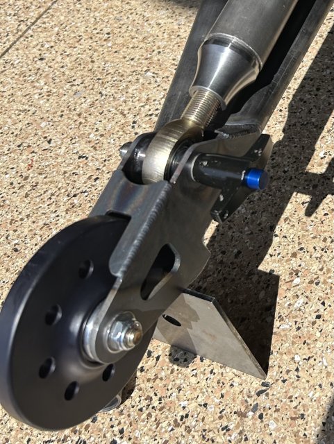

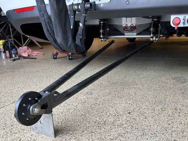

Another interesting thing coming up 🤓 I’ve decided I’m not doing this shit (at least to start) without a wheelie bar. The new suspension is supposed to keep the front down but I can’t find my written guarantee that this thing isn’t going to launch straight up to the moon when those wastegates close. So…. I’m going to build a special new kinda thing called an off-set single wheel wheelie bar 😎. I bought a build it yourself kit from Quarter-Max. The single wheel is offset to the passenger side. It moderates the hit on the right rear tire where it’s needed the most and of coarse will put a stop to an uncontrolled front end launch. One of the problems I have now with a conventionally mounted wheelie bar is there’s no room for the upper bars because the car sits so low on the rear tire and my fuel system (pumps) are in the way. This new setup is placed lower on the axle and will be parallel to the ground at 6” all the way from directly under the axle to the wheel. Not a lot of these out there yet but I talked to some builders and they say that testing on Pro Stocks and even Pro Mods has proven that they work. No doubt I’ll get some WTF’s 😝 IMG_8358.jpeg IMG_8357.jpeg IMG_8356.jpeg

I've seen a single wheel in the middle, but with offset I'd be worried about 1 rear tire coming off of the ground when the wheelie bar hits. Hopefully they've figured that out.
4,116
10,335
Are you still running a radial? I dont see this playing nice with a radial tire.
I’ll be doing more small tire (10.5) 1/8 mile class stuff. But also 315 radial. The new suspension is very tunable. Not at all like what I was running so we’ll see.

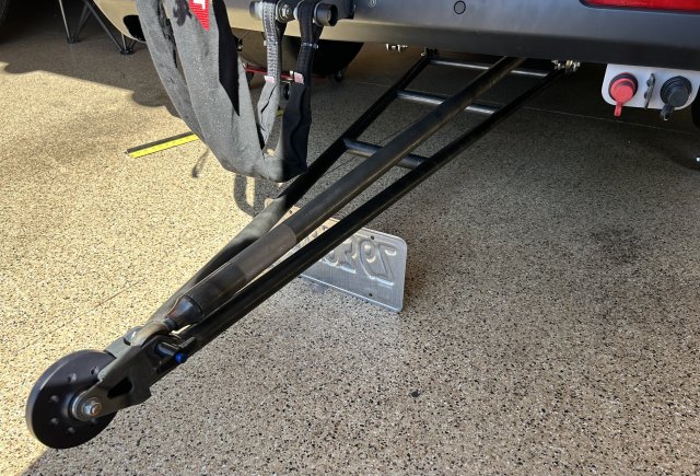

Thread Starter #1,769

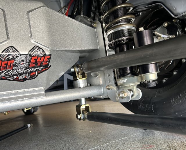

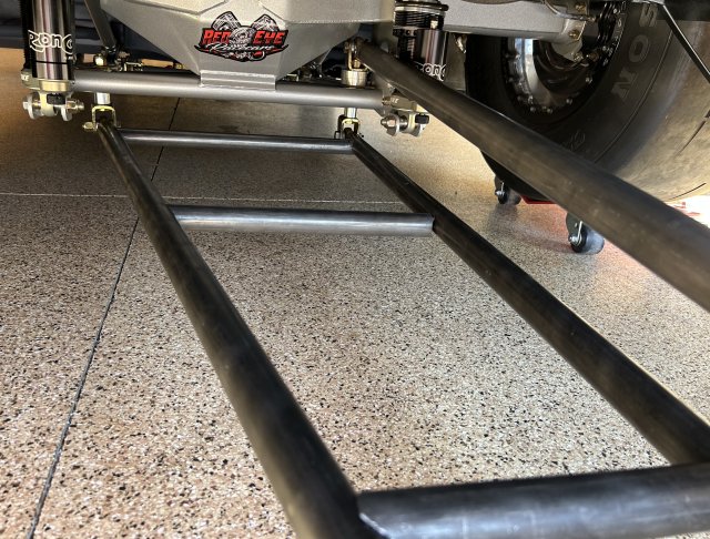

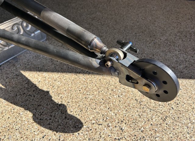

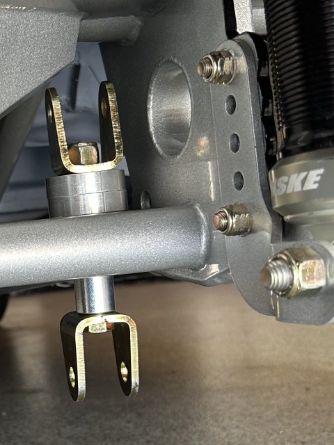

Some progress made on figuring out how to make this bar work. Still cutting and tack welding the fittings to get the bars to come together at the wheel. Figuring out the upper and lower bar attachment points with the lengths of the bars has been a puzzle. I think I’m going to have to shorten the total length to get it to do what I need. Engine build is still in progress. Fitting rings and bearings tomorrow IMG_8414.jpeg IMG_8413.jpeg IMG_8423.jpeg IMG_8431.jpeg IMG_8452.jpeg

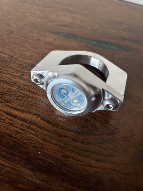

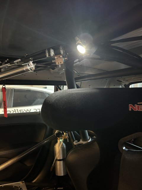

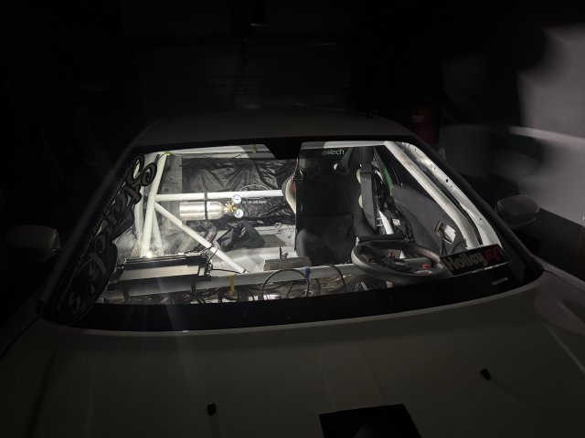

While I’m here…. I came across a super nifty interior light. With the wiring redone for the race setup, one thing that wasn’t considered was a light to allow me to see inside the car at the track at night. Couldn’t see the shifter to tell what gear I was in while in staging. Problem solved! A billet roll bar mounted LED. Push on/off. $40 😎 IMG_8417.jpeg IMG_8420.jpeg IMG_8421.jpeg

I'd want a red or orange led "mood" light on all the time at night so I could see things. You guys think about that?

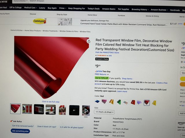

Done ✅. Bought this to put on the lens. Red window film. That way it won’t affect night vision and the inside of the car will glow red. IMG_8468.jpeg

I’ve been waiting on my $50 tube notcher from Amazon. All together now and just the finish welding left to do…. 👊. I’ll have access to the shop next week to get that done. Nothing else will getting done because everybody else is doing a week long drag-n-drive in the Northwest. Adam threw together a rusted out Pinto and put a twin turbo 5.0 in it. I told him to text me a picture when he’s stranded on the road in the middle of Oregon 😂. Not my thing IMG_8515.jpeg IMG_8513.jpeg IMG_8512.jpeg IMG_8511.jpeg IMG_8510.jpeg IMG_8509.jpeg IMG_8508.jpeg

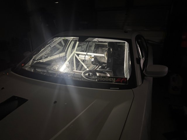

in regards to interior lights I did big leds on the cage. In my garage no exterior lights on.

Yes. I’ve always run a ballistic diaper with the absorbent padding. I experienced not having an interior light after dark at the track the first time out with the DragPak setup a couple years ago. I couldn’t see anything. I ended up getting a flashlight to put between my legs to be able to see what gear I was in with that M&M shifter. Felt pretty stupid. For me it just needs to be enough to see where everything is. The red tint for night vision will be good to just leave it on when the car is running at night.
