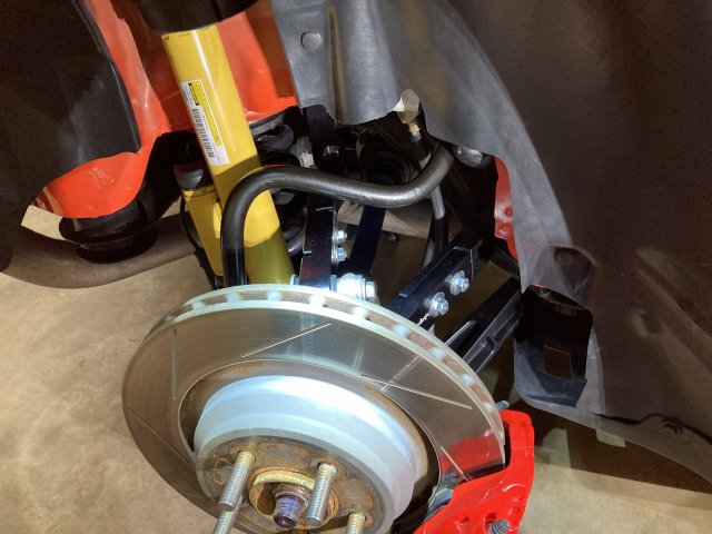

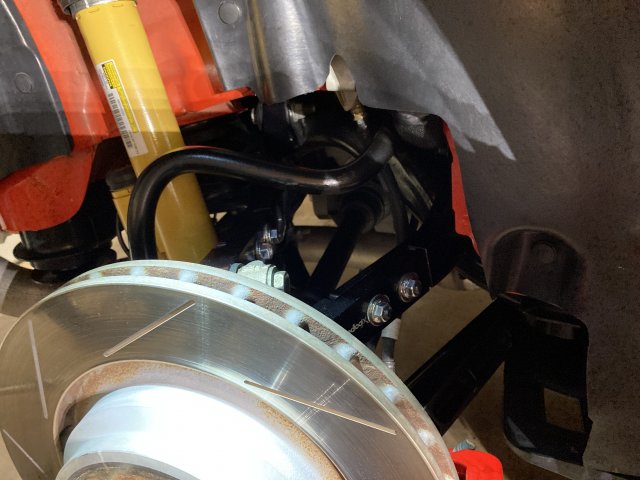

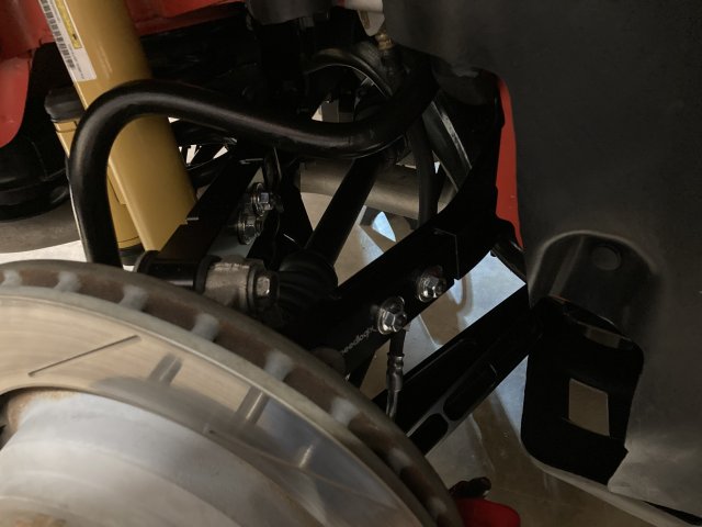

Done, from this
To this
The Speedlogix ones use serrations, each click is .030”. I set them 2 clicks out from matching the OEM arms.
View attachment 20090 View attachment 20091
Installing the 6 arms was a breeze, the Diff Lock Out kit was the time consumer. Could do a second one in about 2/3 the time this took after knowing how it’s done now. It’s ready for a test blast.
I shortened a 4 foot level to fit flat on the wheel lip too set up arms before I did the alignment an it worked great.

I plan to do AAD hardware but also need a shorter link BUT at least one of us has seen interference between the sway bar and AAD with shorter links. That was DGatzby with the Razor's Edge/StolenLogix billet rear links.

I’m just guessing, but I bet those are a early AAD arm design that Speedlogix labeled with their name. They stole AADs harness bar, so why not these. That adjustment setup is actually pretty nifty as long as it stays tight and doesn’t move. I think making sure those bolts don’t loosen and you end up with a self adjusting control arm will be important. I would suggest besides checking those bolts frequently, that you paint a line on the arms in that adjustment area, so if they change position you will be able to see it. If they loosen up they could saw those serrations flat and ruin the arms. The current AADs can’t do that because they use tabs instead. Good job btw on doing all that on your own. 👍🏼

THANK YOU, It was a job but it’s do-able alone off jack stands with a floor jack. Yes, the Speedlogix arms are AAD copies except for the lock up, side by side it would be hard to tell
them apart except for the tabs.
These early lower tension arms are exact copies of the AAD ones. On those I suggest the Spheriflex bushings in the lower arms as getting the bolts in in the poly bushings ones is a bit tough. The best part? About 400$ for the complete 6 piece set, MUCH THANKS Hpindy!!
(Edit to clarify thank you Hpindy!!)

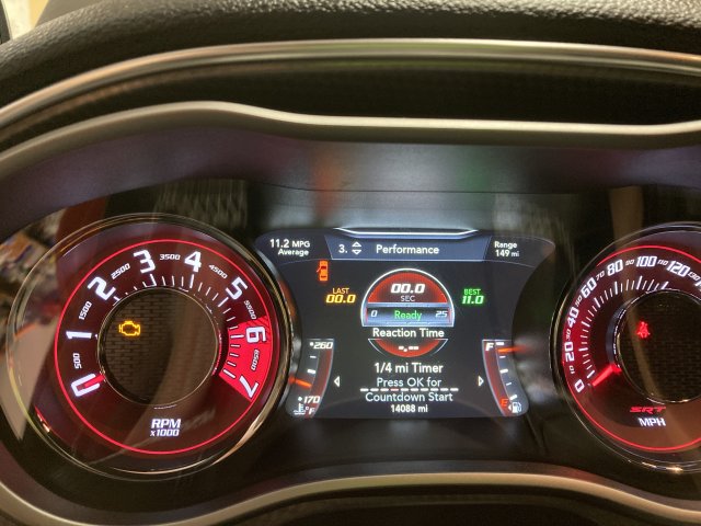

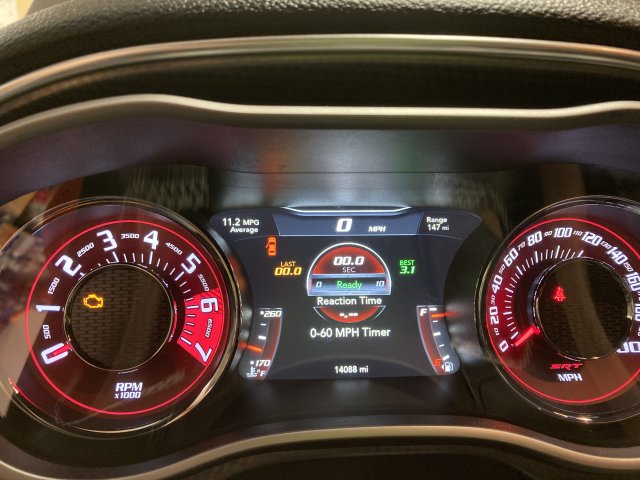

I couldn’t wait, no traffic, bridge to Mexico was all mine. Probably my best street 1/4 this season according to the car, battery positive just pulled while doing the work yesterday, my Gtech timer out for upgrade. It’s 88F here, Nitto NT05R at 32 psi and hot, no burn out. Spun in first and a bit in second peddling it but pretty impressed with the times. Now I’m home and will pull tires for inspection of arm bolts and for any rubbing. 273553CC-2B96-4839-AF3B-765FA8A02C6B.jpeg E84B904A-A3AF-4681-AC13-515EBD1FC8D6.jpeg 105B27F7-C813-4C3C-BF1E-F3E9324E671A.jpeg C6153C26-A5B4-4795-AA71-81FDF5C58A94.jpeg But here it is from the car timer.

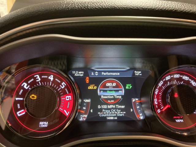

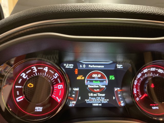

So far so good. Nothing moved and all stayed tight and no signs of rubbing.
G’s, pulled .85. On my 9.998 pass at the track pulled 1.68 G’s. Hoping to get to the track again soon.

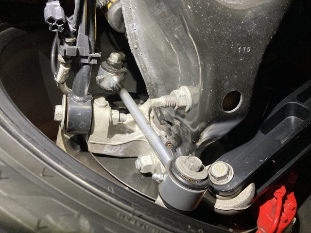

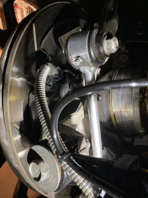

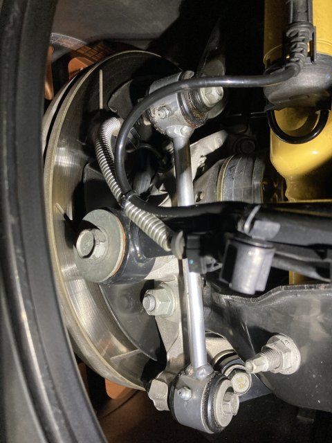

Man that looks close but if it clears it clears. I guess they are 1" shorter than stock according to an older sales page I found.
I need the end links before I'd need the arms. I should probably order the full set F & R.
3,689
8,703
These are 9” center to center, I think their 2” shorter then stock, measure yours and you’ll know. They don’t look like they could hit any where.
