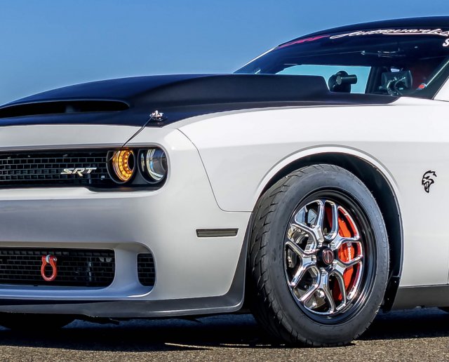

I see a lot of people outside of the hellcat world running the hoosier dr2. Why is that not a popular option for us? The 325 45 18 has almost identical sidewall as the 315 50 17 MT but 5 lbs less weight per tire. Seems like it would be a great combo for a 3.09 geared car. 30" tall tire with a lot of sidewall plus less weight seems like a winner. Do they not hook?
I think not too many people are running 18's , most are on 17's & the high hp guys are on 15's.
The Hoosiers have a softer sidewall which generally do not work well with heavier cars or higher power levels.

The trade off with going to the bigger tire is weight. They are heavier. One could assume that its going to cost you some mph. It will be interesting to actually see the results with a highly documented performance car such as yours. Looking forward to reading all about it.

Sorry but the only suggestion about the fronts I can make is go to a frontrunner. The weight savings with the lighter wheel and tire, in addition to the decreased rolling resistance, will show up on your time slip. The M/T Sportsman is even a excellent street tire and is designed for the heavy weight of these cars. I run mine at 40 lbs on the street and go up to 65 lbs for the track. C6046C96-2D73-4D5C-9CCF-4D9FD468B6EB.jpeg

There were quite a few guys who ran Slicks with the 6 speed HCs.
I've been running 18s, 309 gears and MT ETrs since 2015. It's a combo My husband thought worked well together. I'm hooking with it and I'm not changing.
