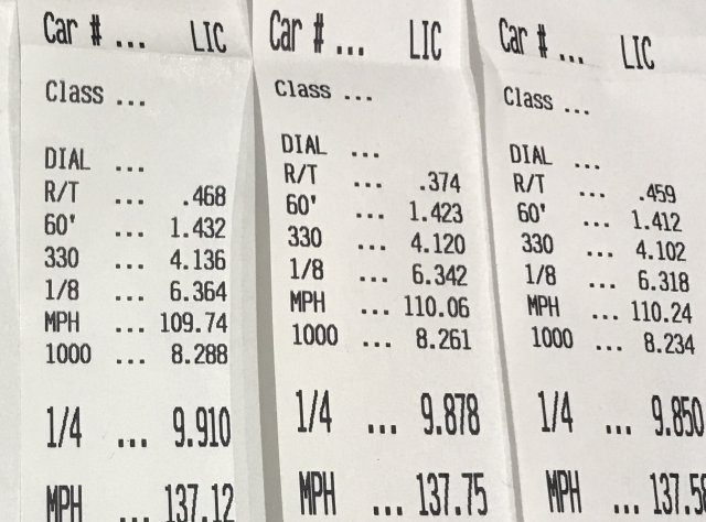

I’m curious to see if your tune tweak will help. My car is also tuned by OSTMike and in good weather and track prep will go 1.39s to 60 consistently with a best of 1.37. I street drive my car a lot also and it is all factory suspension/brakes, 2.62 gear with a 18x10 wheel with 305/45 18 et street r.
I'd be thrilled with those 60' times. What mods on yours like pulleys etc and what are your 1/4 ET and MPH? Sounds like we're pretty close on everything you listed so now my ears are perked up LOL
