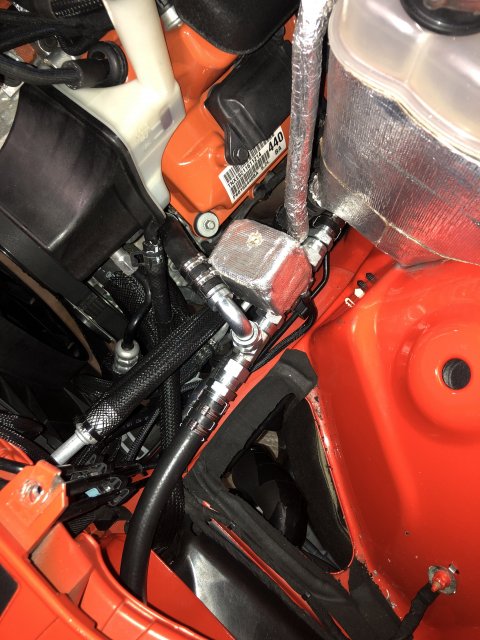

Here’s a picture of the most challenging fit, the drag valve spliced into the suction so one cut of the hose ended up on the money to T into the compressor inlet. A 45 on the fire wall side here probably make it a bit easier. I’ll be relaying to Kincaid as well so he can customize the Hellcat kit.

Nice solution on insulating the intercooler coolant piping... you've spent a lot of time on insulation. Looking forward to the results.

It’s all insulated, every inch of pipe/hose and device, even the pump, has intercooler radiator bypass as well. This is the Larger drag KC unit with a a 1 gallon hopper tank as well so I’m expecting a measurable result!!
