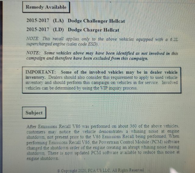

Heading to the dealership now. Laptop in tow to read PCM after and see how they fixed it. Could go wrong and they could break it more!

Just got a text from my friend who is my tech at the dealer ship, he got an alert from his manager that the fix for my PCM is in, he is running my VIN now and will be getting back to me if it is available.

Wanna hear some better news! Just got home and the sound is not occuring on shut off. Later tonight I'll be doing a deep dive in the PCM to see if the tune changed or if the PCM flash was deeper in the firmware. I'm happy that FCA finally fixed this. Might be placebo but from 0 to 60 she put me deeper in the seat on entering a highway. RUMINT says TCM also had some updates as well according to my friend.

Reading the PCM and TCM as I write this post. Looks like I have to send the read off the HP Tuners so they can update their beta software. Looks like the PCM and TCM software changed again. Should be a few days before I can tell what was done to the tune, will post back then.
UPDATE!
So I got a read to finally happen, had to select GPEC2A PCM manually. V86 OS was: 05035700AM. V86 OS fix is: 05035700AN. I did a diff and nothing seems to have changed in the tune. Throttle is still at .10 but I think the flash fixed the out of order operation of shutdown, which is what we needed (and way deeper in the firmware than HP Tuners can read) so I'm going to send the HPT file and system information off to HP Tuners and their Beta should be updated shortly.
