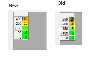

Cutoff, DFCO -> Misc Cutoff -> Torque Reduction
This one has me scratching my head...

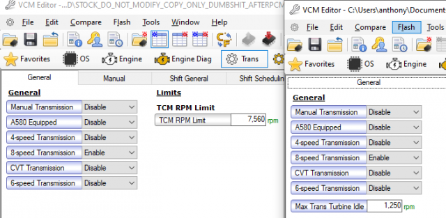

Now to discuss Transmission, this is where things get weird for me, in my pcm read prior to the flash the only thing that shows up in the Transmission section is General, Manual and Torque Management. I don't know if there is a bug in 4.4 but in the beta 4.7 new tables have popped up for me, these are: Shift General, Shift Scheduling, Shift Pressures, Shift Timing, Torque Converter. This may be a unique thing to me or a bug. This is beta software so I cannot tell at this point.
Transmission -> General
New to me: [TCM] 5722 - TCM Limp RPM Limit: If the engine RPM exceeds this TCM RPM Limit, Limp mode will activate and a DTC may set.
New is on the left, old is on the right, one option is missing, and a new one has appeared...

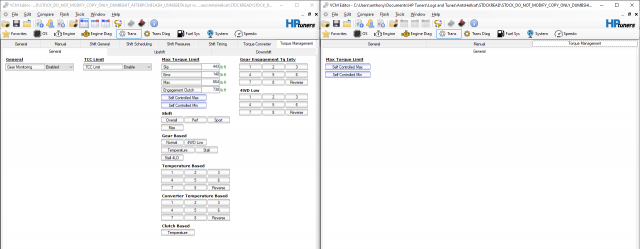

Transmission -> Torque Management

So there were quite a few changes in the new update, mostly around throttle body and torque management. I have nothing to say about the Transmission tables that are new to me because that might be a bug with the 4.4 software when I did a stock read of the PCM. Who knows what is really going on. Figured I would bring this out into the open for others to comment on, please let me know your thoughts or if there is any other data you would like to see. In other news my VCM Scanner is working as expected and I can see all my Channels again in the Beta.
