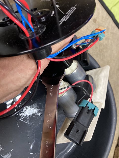

Fuel pump change easy peasy, you can change both in about an hour start to finish. You have a tank bung tool? Makes the job MUCH easier. I posted in my Fuel Rails thread some pictures of how to do it. Hardest thing is getting the fuel connector off the pump set up working inside the tank and tanking the float off blind but it’s really not that bad. Be sure to have some thin section wrenches to get the tube nut off the bottom of the hat to get the fuel pump loose.

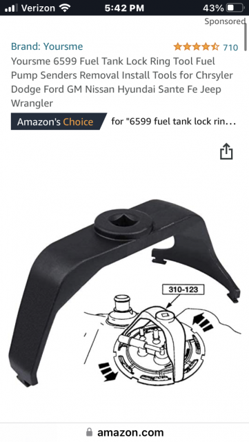

No tank bung tool, but I do have a mallet and a big flat head screw driver :LOL: I'm replacing both pumps. I'll keep the good one as a spare and plan to disassemble the bad one to see if I can see anything that caused the failure.

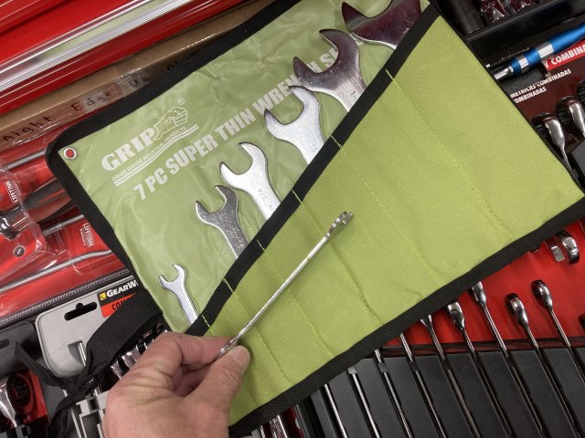

What are thin section wrenches?
3,637
8,555
Wrenches with very thin sides.
Spend $20 on this and save yourself grief on the bung, this the tool I have.
https://www.amazon.com/Yoursme-6599...2lkZ2V0TmFtZT1zcF9waG9uZV9zZWFyY2hfYXRm&psc=1

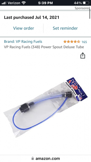

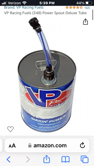

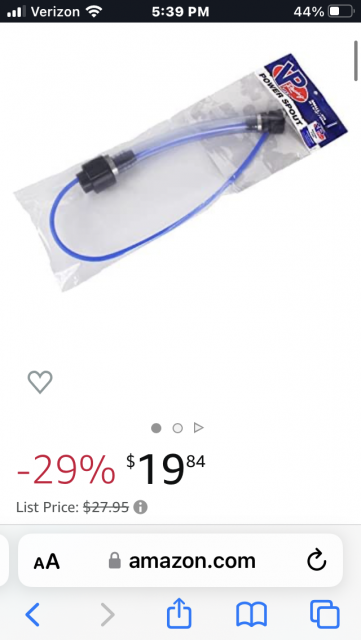

While there if you don’t have this VP filler spout get one, they’re GREAT. Self vent from the tank into the jug, keeps humid air out of your jugs and tank.

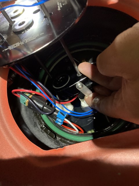

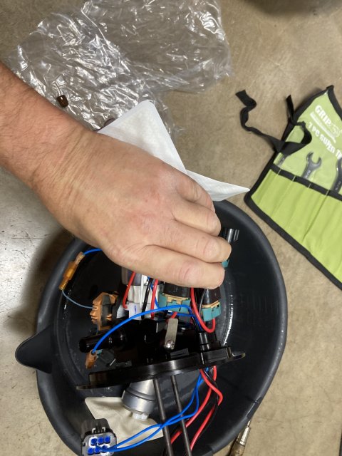

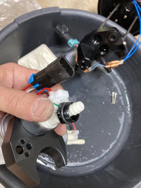

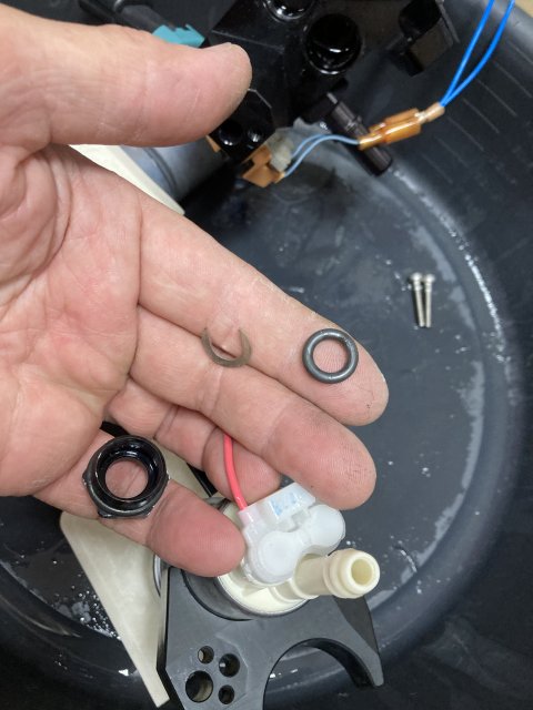

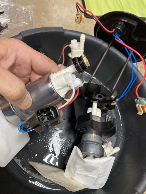

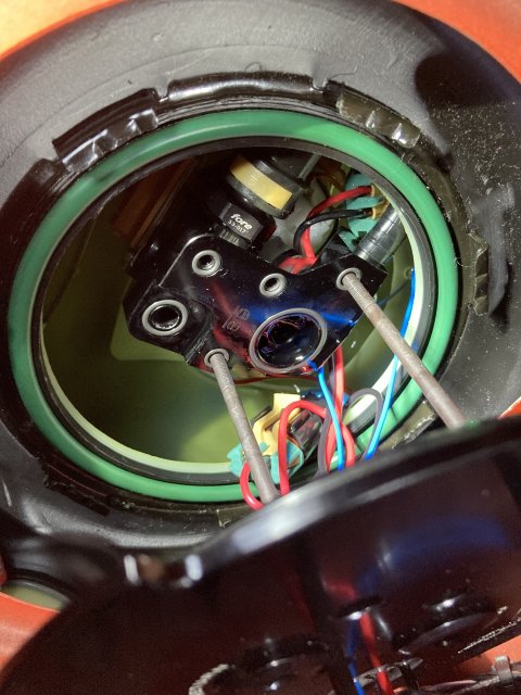

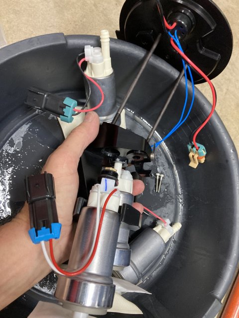

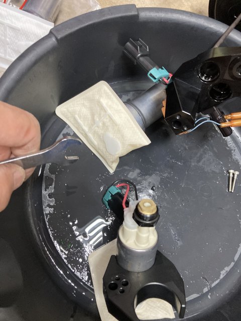

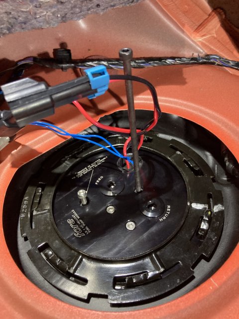

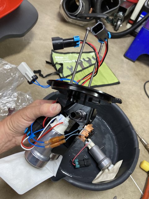

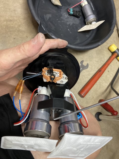

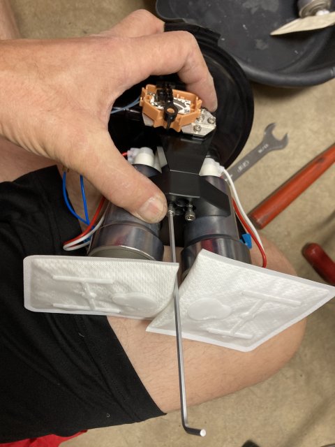

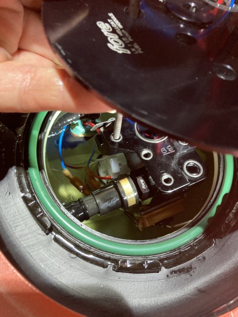

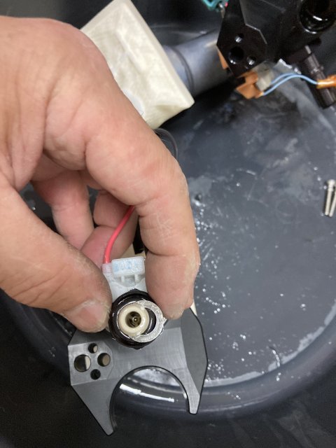

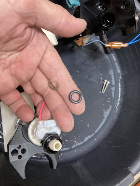

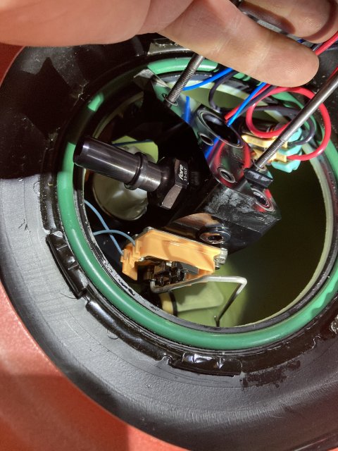

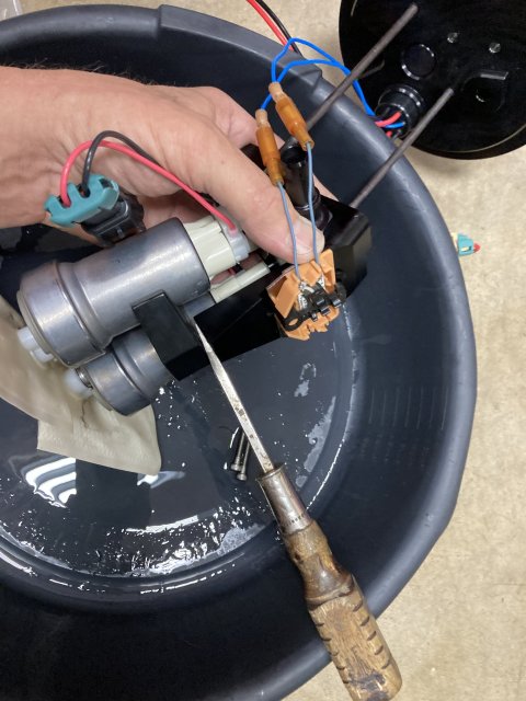

Here ya go some pictures to help what you’re going to see. Your going to need 2 long 5 mm bolts to keep the hat top and bottom aligned properly, and make sure none of the orings fall out of the hat to base seal area 4E86A478-679C-4268-8D24-1AB77341E267.jpeg 9092C30B-D06B-438E-B389-6E2D8A28A302.jpeg 8E78D990-5D6C-4D70-93B6-865DDF765BE4.jpeg 39437211-F033-4B05-8A55-8051CEDD604C.jpeg 2760E04D-6DCD-44A3-B7A7-D7DC78F77892.jpeg D56D1C78-CA06-4FCD-A4EC-D3F488B91601.jpeg 0E42A0C0-5F83-42EF-B42C-3423E336ABFE.jpeg 4206FF08-C8BF-441A-B761-794C95F79053.jpeg 12B4741A-7963-46EF-AA44-53972F18F7D3.jpeg 1F4BC1DA-AE2E-4033-ACE1-FC1B32D4F591.jpeg

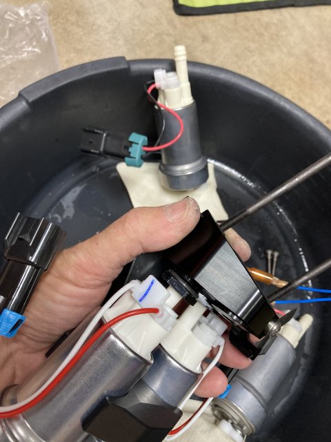

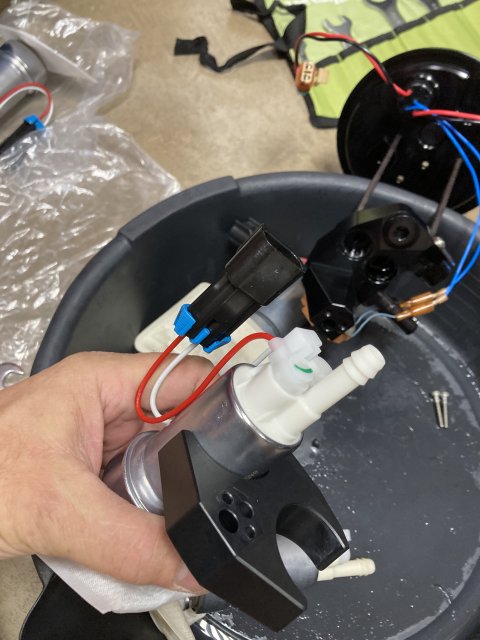

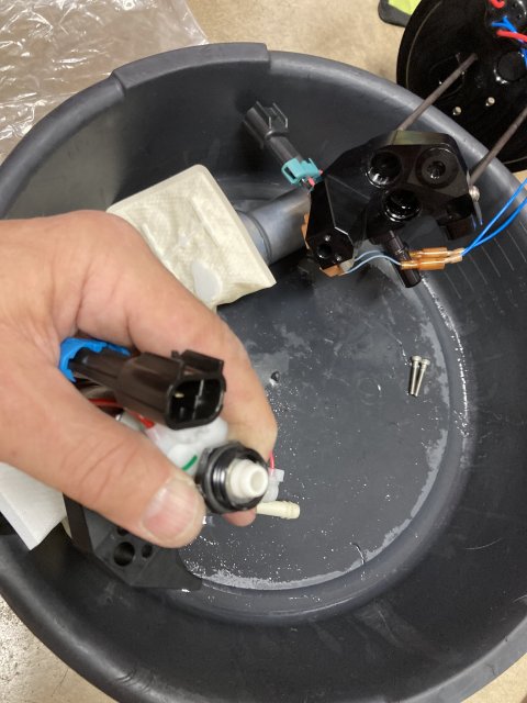

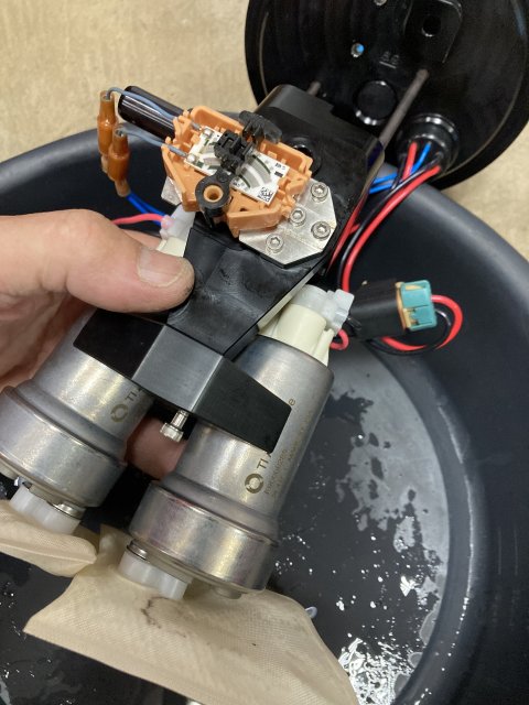

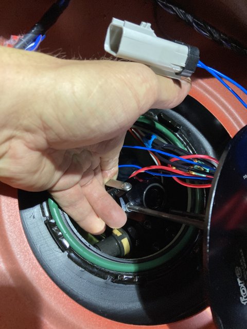

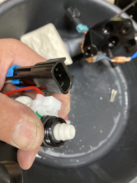

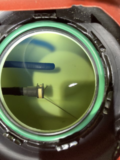

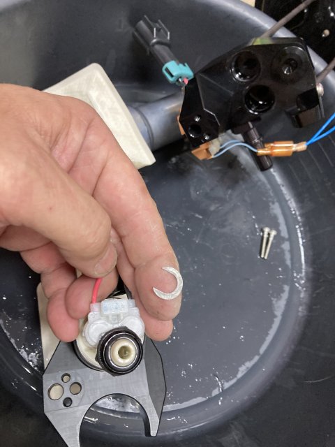

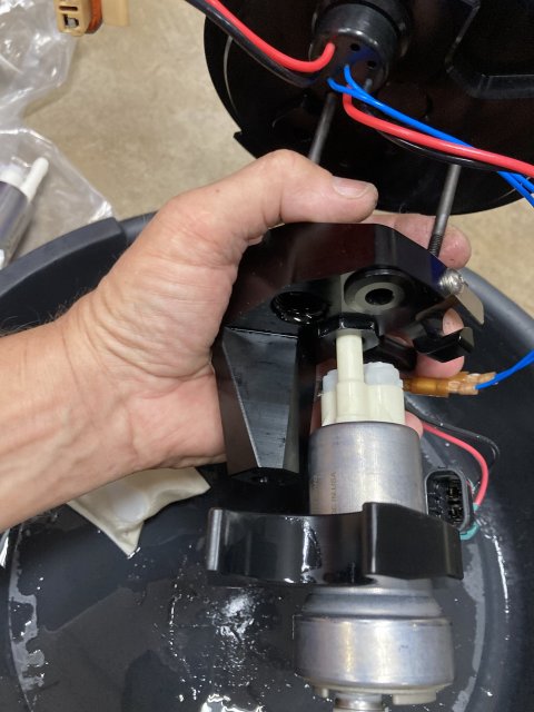

More

Hopefully all these help, tank a oil drain pan in with you and just put the assembly in it, do all your work in it, drain it and tank rebuilt assembly back in with you, no mess, no lingering gas smell.

Unfortunately the pictures didn’t load in chronological order, it’s easy really.

Thanks for those pics. I didn't realize the pumps had c-clips holding them in, I'd have probably just tried to pull them out lol.

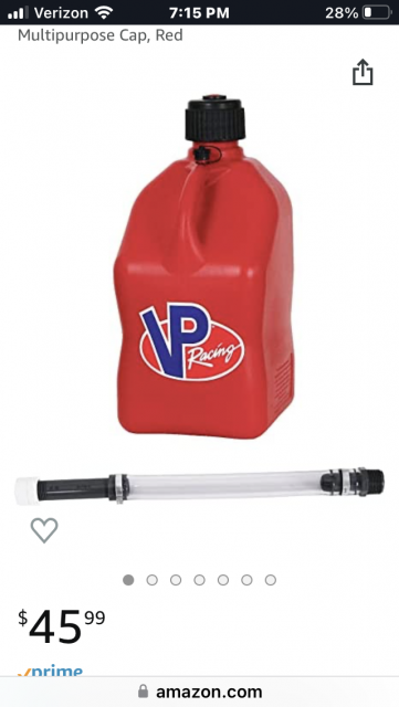

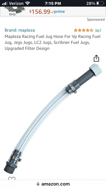

Nice jugs no doubt, notice on the VP can the fill snout has a long blue hose sticking out one end, it goes inside the can and is the air vent to allow the can to empty fast and the can refills itself with fuel fumes being displaced out of the fuel tank with creates a vacuum like effect in the tank and sucks the fuel out of the can FAST and refills the can with fuel fumes from inside the fuel tank not surrounding air which on high humidity days carry’s moisture into your jugs, it’s why I like this setup better over their jugs. What I didn’t like about the VP jugs is where it’s vent is located fuel would at times drip from it on the car or rim when it was nearing empty and get fuel on your hands in closing it to stop such. The can also empties much quicker too with their fill spout, that’s why they call it their Power Snout, plus one doesn’t have to hold the 40 lb can up in the air as long, a BIG benefit for those of use that only lift 16 or so oz’s at a time any more lol. My experience with the 2 at least. Plus the cans are free lol, lots given away or found in the trash at the tracks and one only has to buy one filler tube for $20.

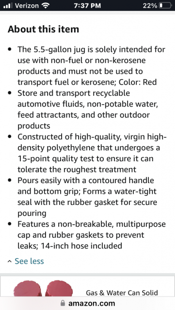

Weird they say this about those jugs too????
191,499
3,637
8,555
I use mine for fuel transfer from the can into the car.
Sounds like from the description they are not an approved fuel transport container?? “non-fuel” liquids
Maybe they make different varieties?
