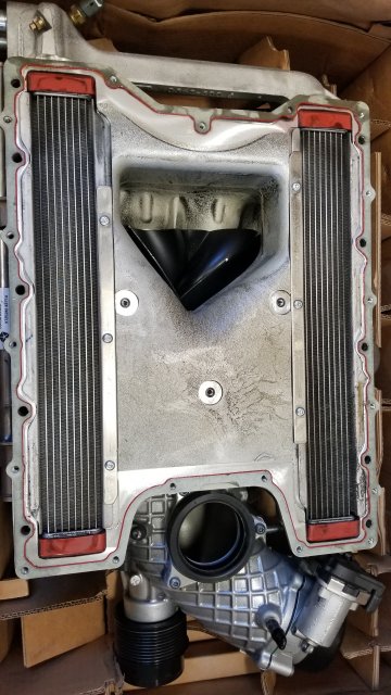

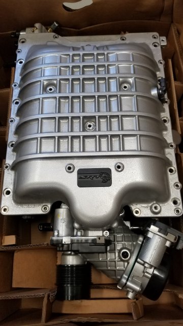

I'm not sure what kinda shape this is in. The price was right so I snagged it thinking I could use parts of it if the blower itself is too far gone for some reason. I was told it was a Hellcat blower but when I went to pick it up it had the Redeye logo on the lid so I assume it's a Redeye blower. History is unknown. Once I saw the Redeye logo I wondered if I could send it out to Jon Bond or Jokerz for a rebuild and have a 2.7L upgrade for GoMango.
It's 100% with all sensors, fuel rails, injectors, throttle body, bypass, etc.

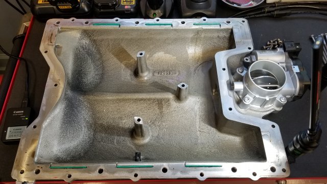

I pulled the lid to take a look and saw some marks just behind the blow off valve. Nothing major but something happened I guess. Rotors look "ok" but have some coating removed and one of them is a tad rough on the edge. I could see no evidence the snout had ever been off based on the bolt heads.
Is this worth sending out or is it toast? Rotating blower pulley everything is smooth both directions. There might be 1(ish)mm of play rocking the blower pulley back and forth.

The one I picked up from Hellno looks a bit worse than that on the rotor wear.
Because of that I've not done anything with it, yet...
It will be interesting to see what other people think of the wear.

I have a spare 2.4L blower as well that I also got for a song. You never know if there are bearing issues, etc so I always price them assuming it'll need a full rebuild and think of worst case scenario if the blower is beyond repair for some reason. I tally up the usable parts like throttle body, bypass, injectors, fuel rails, sensors, snout, etc and let that drive my price vs risk decision.
In my case these were extremely good deals so it was a no brainer.

Great score . I would absolutely send it to @16GoManGoHC2 as my first option for a check over ( jokerz second). It is a straight bolt on with minor tuning revisions as you will be using your current injectors . Keep the 3 bar map sensor and copy the RedEye data to your tune . Plunk a 2.85 pulley on it and make 18 psi . No problem for pump gas if tuned right. You have the injectors and fuel system to handle it . I prefer the 2.7L as it spins slower to move the same air volume but with less heat. .

Sorry, just seeing this, didn’t get a notification from this post, just got one from Hpindy’s.
From seeing the scuffed coating on the rotors it’s either out of time a hair or really worn bearings letting the rotors touch or it just got real hot once or so causing the rotors to touch. Either way it should be checked out to find out why.
