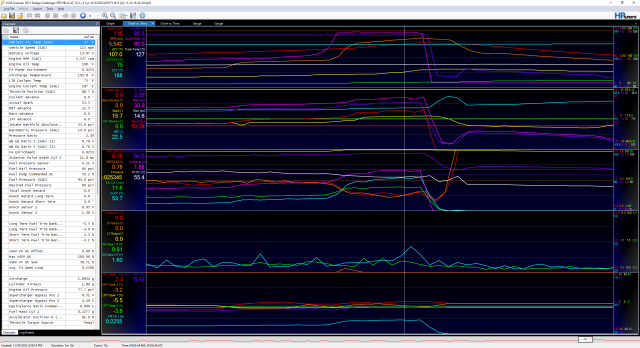

@Speedy! I've been down this path, unfortunately it's yeah run the BAP or upgrade to triples. For my experience when OST was tuning the car when it died at the 660, that was it. For reference here is a wot pull for me at ~20psi.
I am commanding 80psi but giving it 94psi, I should probably back that off at the regulator to 85psi (give it some head room). In some of my other tunes when I was running 104/93 mix it was commanding 94.3 to give it some head room. Since I've reset a lot of those tables that is an artifact. However my FP DC is barely up there. Plenty of room left and the injectors are barely sneezing. (This was a fifth gear pull, and I was only testing to make sure the trans was ready to rock n' roll).

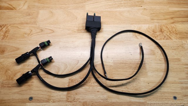

Anyway, hindsight is 20/20. Here's the harness I built and according to JMS fixes the issue. Lunch and then a test drive but to be honest I'm not confident this will work based on my previous testing. 20221203_134732.jpg

Pretty nice looking work for a engineer 😆

Anyway, hindsight is 20/20. Here's the harness I built and according to JMS fixes the issue. Lunch and then a test drive but to be honest I'm not confident this will work based on my previous testing. View attachment 88899
Nice harness, you cannot run the third pump off another fpcm, its not a thing. Thats when you would have to switch to the fc3 from fore. Imo if you are using a triple pump and the stock lines thats a bottle neck. -10an to a Y block then -8an to the rails. Still a dead head system so the only worry would be vapor lock.
