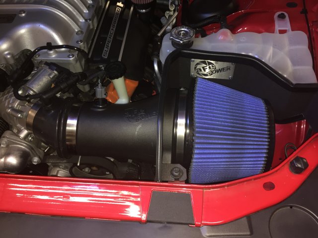

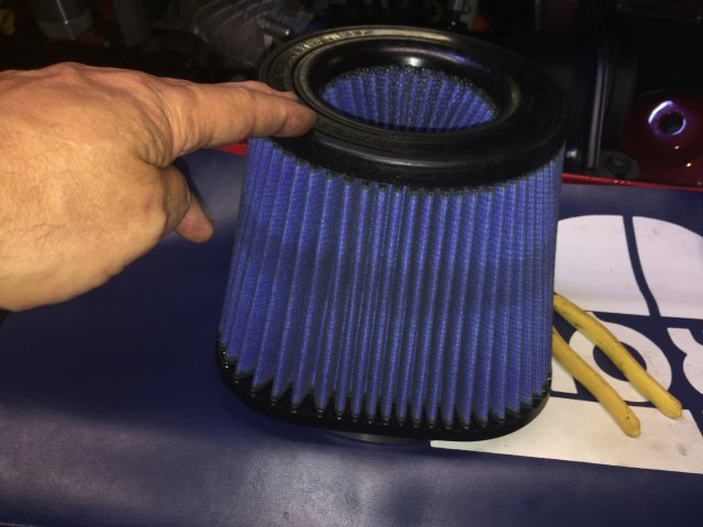

I finally got mine out for a run this week to test my aFe Power CAI. I love the sound of it now when you punch the pedal. The reason I installed it was strictly to hear the SC better. It does appear that the AIT is reduced by 3-5 degrees from what I used to see. As far as my butt dyno tells me, I dont feel a noticeable difference.
I am happy with this intake for sure! 5B9008EA-858B-4E9D-9022-D620ECB64850.jpeg 5CF5A444-4B86-4F70-BFAF-46E16D7C2296.jpeg

So your IAT’s are cooler with this? And when you were looking at them, was it when you were cruising, stopped or combo of both?
While at speed. Sitting still seems to be the same temps I had seen with the stock intake. I have to wonder if the hood vent is helping pull air from below and through the headlight opening While travelling at a decent speed.

How close does the shield come to sealing against the hood with that aFe?
It’s hard to say for sure. I tried putting pieces of tape with the sticky side to see if they stuck to the hood after being closed. They all fell off probably due to the air movement when closing the hood. I may try that again, or possibly pull the hood vent out to look in with a camera.

Thanks for the effort. It’s a CAI I was considering. I’ve checked clearances like that with a couple blobs of modeling clay or blue tack.

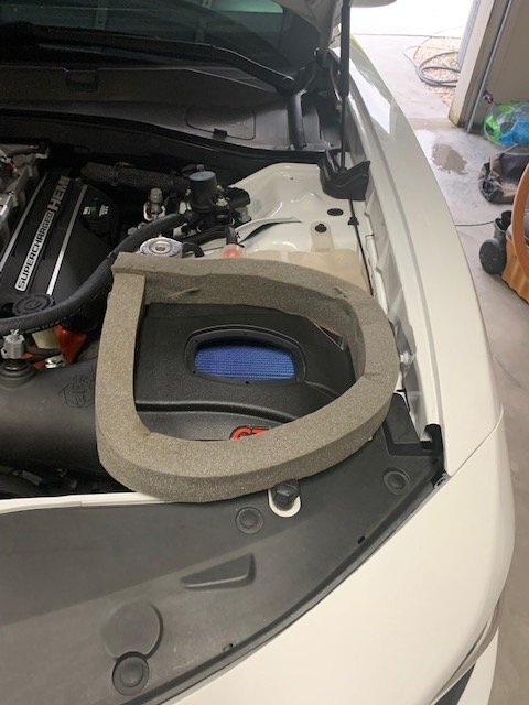

This is what I did with my JLT intake back a few month ago IMG_9621.jpg . I bought a afe off a member and opened the top and used the same seal I made for the JLT. When I drive the car tomorrow Ill see if adding the seal to the hood and removing the plastic insert helps cool it. I also added thermal blanket to the coolant side of the tank and the coolant reservoir.
