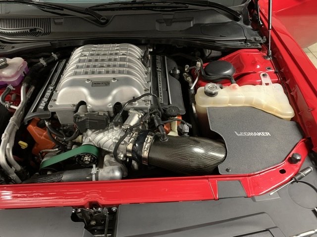

Stock air filter flows better then a K&N. More surface area
Maybe so, but a factory filter won't let gravel and small animals pass through it.

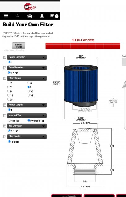

I already looked through Green I don't like the solid cap. 2382 is close
Afe..

For some reason AFE will not let me build a filter. It gives some ridiculous price. Must be lack of employees due to government handouts..

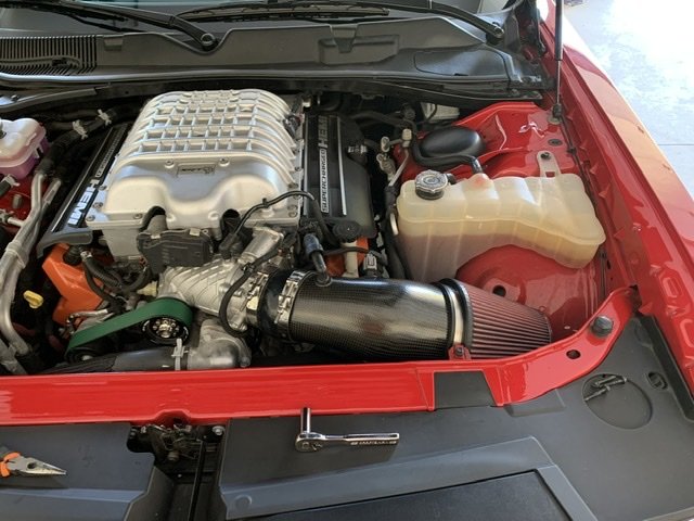

Any chance you can give some comparative IAT’s? Not that I’m asking for a datalog; maybe a pre and post race IAT note for both setups?
Jon and I will both be testing it. Best way is going to be with a datalog. I could find most of that info on the street, I don't think it moves a lot unless the car is idling for a bit
Don't worry about anything else in this log but the iat this is a still work in progress flex fuel tune. But this was a 2 mile drive. You can see temps at idle at the beginning pretty warm as I was sitting there idling looking a few things over. Then I easily drive down the road. Only about a 2 mile drive and then I sit in my driveway for a few. I need to add a timer to this because I don't remember how long it was but it wasn't to long. This is with the lid off. It was about 80 out at this point. I'll have to look for old logs with the stock box on. I know I have similar logs.
From what I noticed stopped is warmer but moving it cools down faster. I'm going to be curious how it does through the staging lanes. I don't want to push the car but I also don't want them at 130 by the time I take off.
