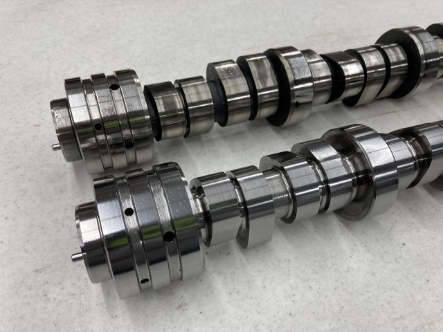

Looks about an inch longer too!
haha
Optical illusion from camera angle. Every dimension short of the lobe geometry is exactly the same as the stock cam including the length to the thousandth. After FAS screwed me with a bogus ready to install inlet plate I QC EVERY part I get from now on. Lobes you can noticeably see the duration difference, from egg shaped lobes to oval lobes. 5DB6B772-6DB0-4914-A8B7-71E91682C71E.jpeg

Optical illusion from camera angle. Every dimension short of the lobe geometry is exactly the same as the stock cam including the length to the thousandth. After FAS screwed me with a bogus ready to install inlet plate I QC EVERY part I get from now on. Lobes you can noticeably see the duration difference, from egg shaped lobes to oval lobes. View attachment 38748

Yeah that cam is WAY different. Explains a lot of what I've seen, and felt, in the Redeye motor upgrade on my car.
