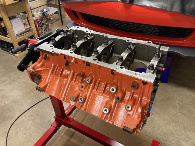

I removed and measured every one LOL. Tops where .018 to .020 except for 2 and 8 which where bigger at .022 and .024 and 7 huge at .032”. I think they got this way from butting and wearing hard on their OD’s pushing hard against the bores while in a butted state, 7 because it had so much ring directly exposed to the combustion chamber with the brow piece gone. Amazing the cylinder bores showed no signs of wear both visually and with a .0001 graduated bore gauge.
Interesting to note as it drove me bonkers with main bearing clearance as I was getting main bearing clearance at .0002-.0003” was until I but those tiny 8mm side bolts in and torqued them to the rated just 25 ft lbs doing such openness the mains up by .0006” and put clearance on all 5 at .0009”. New C bearing replacements where exactly the same as removed bearing thickness’s to within .000025”!!! Yes, that’s 4 zeros and a 2!!
Here’s the bare block with torqued caps waiting to go to the machine shop for cylinder bore honing.

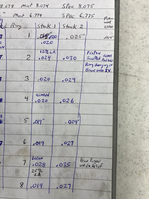

So top rings were right in spec, what about the second ring? .0197 - .0299?

That info on second ring gap dimensions posted about 3-4 posts above this, second rings where .024” to .029” so they where all right in the window except for #7, it was worn out to .035”. Here’s the actual stock ring gap numbers top down 1 to 8. image.jpg
