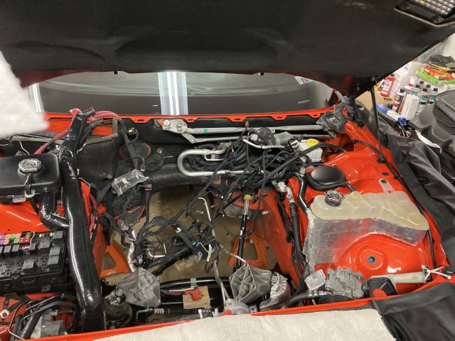

Where did my engine go?????

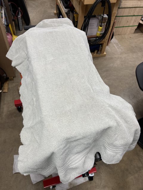

I thinks it’s sleeping under this blanket?? C95CB444-F390-4E9C-8961-9CF255633101.jpeg

Yep, there it is!! Poor thing must have been tired and needed some rest.
But O my God, it looks like it’s missing a few pieces????

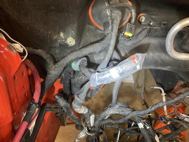

10:1 here’s the next fuel line restriction, the connection with the green lock. Most likely its going to be a rolled over connector just like what was found at the fuel rail connection. And my hunch is back where the line starts at the fuel pumps I’m going to find the same thing. I’ll post pictures of the findings once I get there, first have to test fit new pistons and rings to see how much the block may need honed for correct clearance’s. The bearings, journals, and crank look like new yet. They’ve taken a beating these last 10,000 miles, testament that PUP0-40 is a good oil. C5483DE2-5262-4C74-93FC-862CE580784C.jpeg

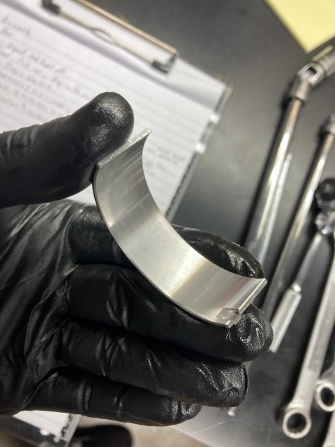

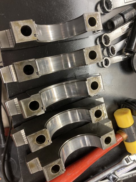

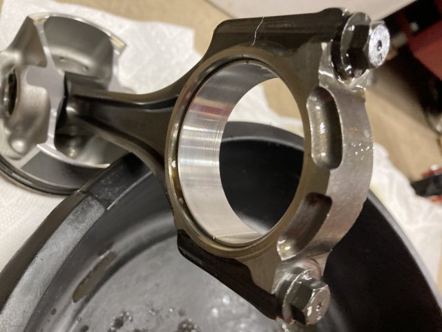

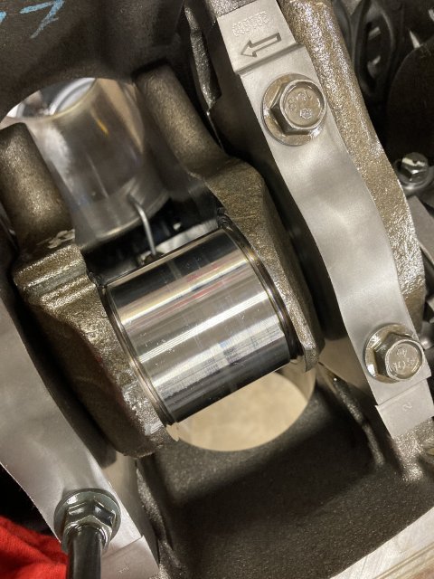

Here’s a view of the rod and crank pressure bearing sides of the bearings, they don’t get much better looking then this enduring probably 1100 crank HP going to 6600 rpm’s over and over as I’m not easy on her EVER. I’ll be replacing them with genuine OEM bearings again for sure. 87E18DF3-D4AE-4C6F-8516-B02B4521FC2F.jpeg D23D0914-9448-4B34-BD43-2D1066D54265.jpeg 7198FDE6-9AEB-4DAF-8452-6CF690479174.jpeg 9B092A3A-7384-484A-9B18-0A7ACFD54501.jpeg 7D9C2834-B654-4942-84CE-64D8507FEDE1.jpeg 0CB8F428-A9C4-468E-AAC6-7F1F80C0A25F.jpeg

Here’s a view of the rod and crank pressure bearing sides of the bearings, they don’t get much better looking then this enduring probably 1100 crank HP going to 6600 rpm’s over and over as I’m not easy on her EVER. I’ll be replacing them with genuine OEM bearings again for sure. View attachment 37561 View attachment 37562 View attachment 37564 View attachment 37565 View attachment 37566 View attachment 37567
Damn brother, did you just get bored & decided to pull the engine. :LOL:
Bearings do look pretty good.

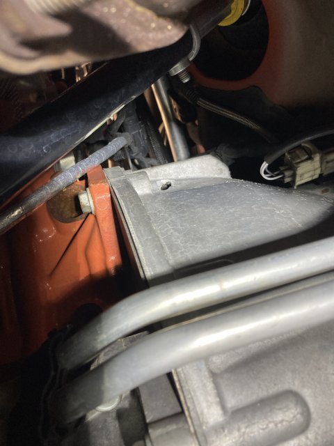

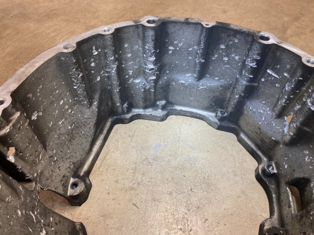

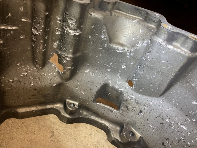

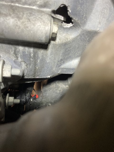

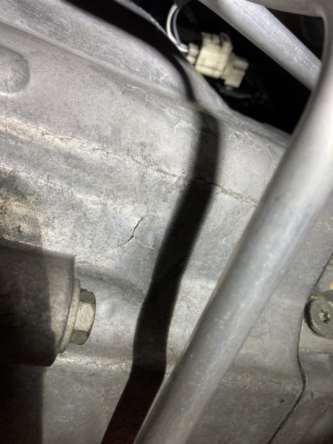

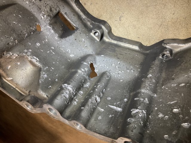

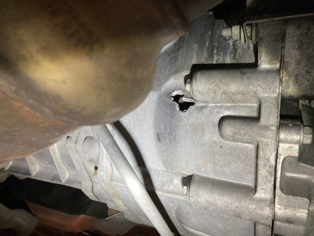

Yea, shoveling snow every other day drove me lu lu and I cracked LOL. No, actually upgrading pistons and rods was a winter project dreamed of for this year but time and energy not there BUT my boy after being back in college classes just one week came home sick, tested positive for COVID so I’ve been hiding in the garage as much as possible and yes, got bored and said WTF and dug in balls deep and here we are, a totally stripped block waiting to go to the machine shop soon as torque plate from a buddy arrives to hone it with. Then it’s put the puzzle back together. Started with taking the trans to change out the clutch and just kept going. LOTS of interesting things found. Here’s one, this was probably some of my knock, this is why steel scatter shields are needed. This is what I was greeted with when I first crawled under her, simple little bolt came out of the TO bearing assembly, just think of it was the clutch itself how long the flimsy bell would have contained it. Warning, M6 owners may not want to view these pictures, you may not want to flog on your baby no more and turn sissy and go auto.😂
ECC76B5E-161E-41CB-8AD8-A474CA631B36.jpeg 944AF054-F8B0-4539-B9A3-8F88F962BE79.jpeg 4E763915-B9C1-45FB-8017-A5566F7D0EC0.jpeg 82FDBE8A-CB10-4D35-9F1A-96F6C108FE6A.jpeg 5F7792C3-B13A-4CCF-B825-C5BDAE46F5CE.jpeg D730BDD7-E073-4E73-A2B4-ED1040C4633A.jpeg 12ED3A89-7514-4A81-9FF6-879FA2BA8007.jpeg
PS, never found the bolt, just the hole it was supposed to be in.

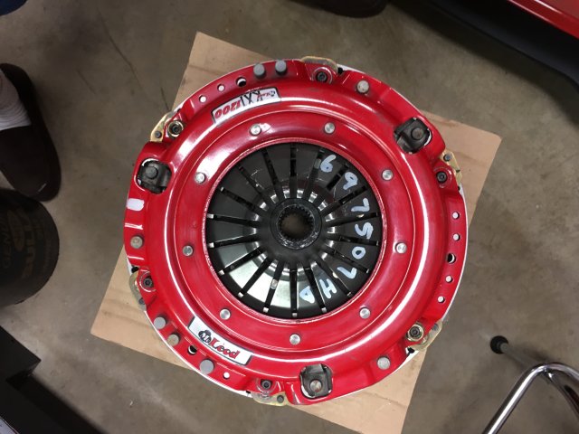

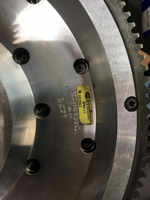

Time for this stuff
77343368-3C24-4C7D-9E1B-907F209C95CB.jpeg 5ACA506E-0321-4F3B-968F-1D17633E6E8C.jpeg B8ECFE93-D7D9-413E-A6DD-30D8FF0FEDC1.jpeg 34D37F64-E2E8-47BA-80FF-CA755397C6EB.jpeg

That looks familiar LOL. Be SURE to check the throw out bearing measurements. I had my trans out three times in the old car due to a spacing issue. Car shifted fine cruising around town but as soon as I was at the track it wouldn't allow shifts. Ended up being the TOB distance to the clutch. McLeod had sent the wrong disk pack or something.

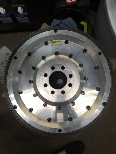

I took a shit ton of measurements for comparison purposes, I don’t want to be playing musical transmissions for sure. Just putting a steel bell on can be a days work or more as for me it’s got to be on center within .002 TIR and parallel to the block within that amount as well. Last one I did was a 2 day debacle and these bells aren’t light, that one I did under the car, this ones going to be done on the bench.

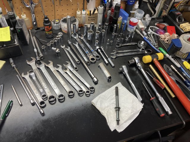

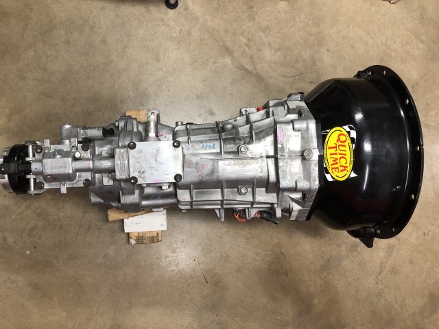

For those that think it takes a shit ton of tools to do this what’s on the bench is all it took, trans and all.

That and don't see the pry bar either lol

Thread Starter #118

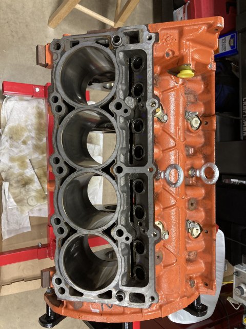

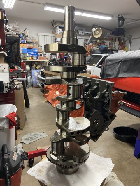

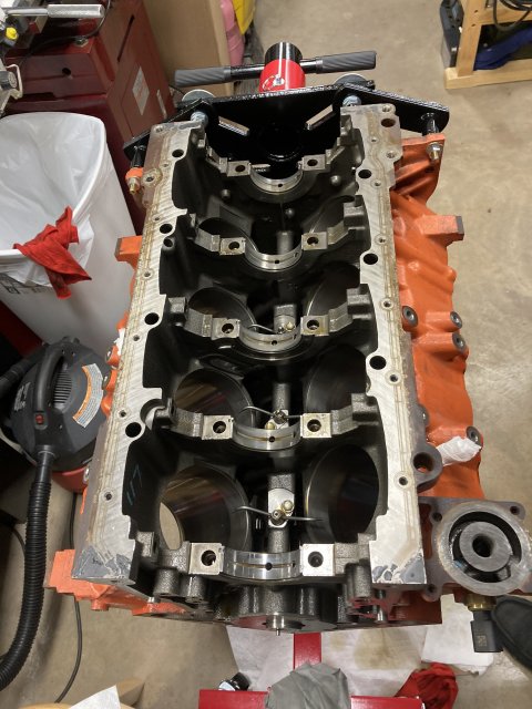

Here she is, bare ass naked not even panty’s on, please, keep both hands on the keyboards guys 😂

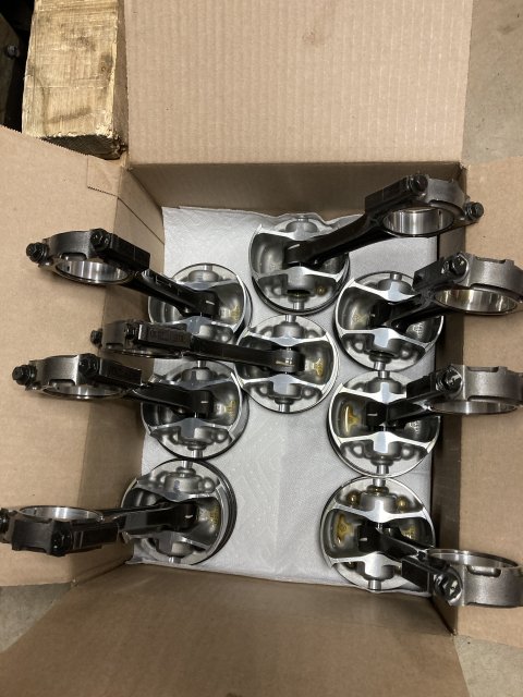

Tomorrow get out the replacement pistons and check piston to wall clearance and preliminary ring gap. And then on to the heads. COVID quarantining in the garage isn’t so bad after all LOL.
