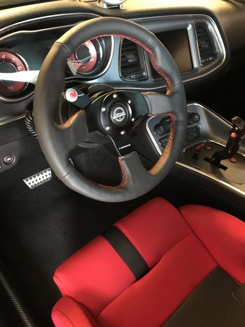

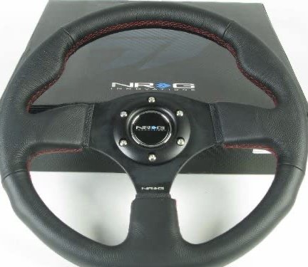

It’s getting this NRG race wheel on a quick release hub so it can be removed to get in and out. I can do without all of the button functions on the stock wheel. I’ll just pretend that I’m back in the hotrod days when we didn’t have all that crap. I will be placing a real line lock button for a Hurst roll control. I’ve had enough of the malfunctioning Burn Box. 7409376C-918E-42F9-B4C4-D8866DF1FB48.jpeg

He's going to to relocate his power steering pump, A/C pump, alternator, all the ABS stuff just to make room for all his idler pulleys

It’s getting this NRG race wheel on a quick release hub so it can be removed to get in and out. I can do without all of the button functions on the stock wheel. I’ll just pretend that I’m back in the hotrod days when we didn’t have all that crap. I will be placing a real line lock button for a Hurst roll control. I’ve had enough of the malfunctioning Burn Box. View attachment 17877
That's it .... It's a full tilt race car now ! You removed the horn

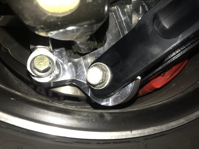

No I did not have to grind anything with the new billet spindles. That's basically the whole point of going with those The stock spindles were ground all to hell. Here's a picture of the clearance with the new spindle. Of coarse that being said.... all wheels are not going to be the same and another wheel may have less clearance. I have Billet Specialties and the caliper has significant clearance inside.
You can also see in this picture how much was ground off the end of that sway bar link. Those are the adjustable links also from Carlyle, and when used on the stock spindles need to be ground down to where theres almost nothing left to hold that heim joint together. That will be replaced when I can track down one the right size. IMG_9935.JPG

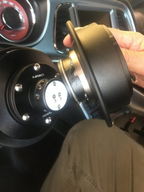

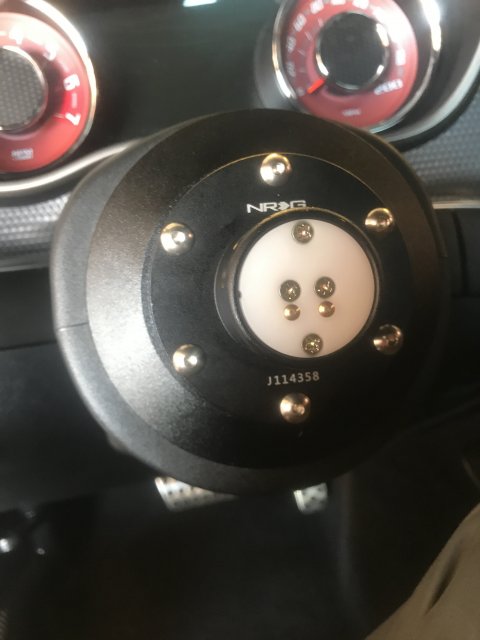

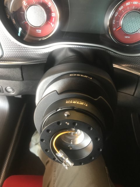

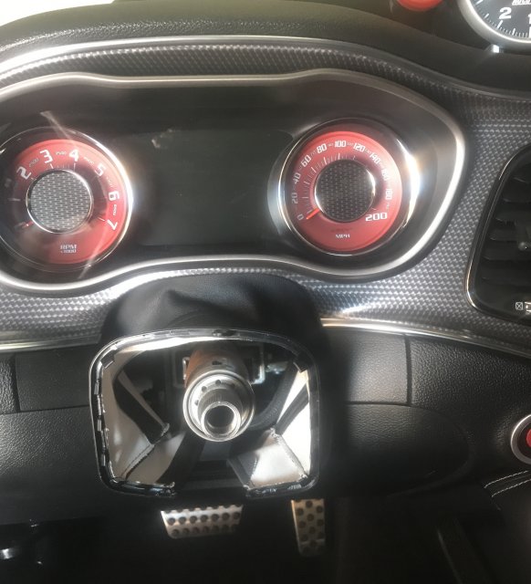

Making headway with the quick release for the steering wheel...... 37F7F3C0-73CF-4C65-8F96-711AB604E737.jpeg 6EA36F5B-8748-4E79-8C86-97470E61E8E7.jpeg 60316CB0-0D71-4B7B-B889-24E10F41AD84.jpeg

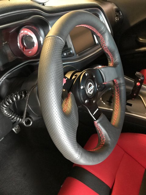

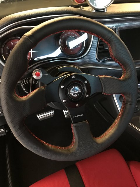

297495A2-FD55-49ED-893C-CCE0C1AE4069.jpeg 79688D3C-08DB-449E-954F-8BAA5AF4DF35.jpeg 0BFD5D6C-D07B-4AD8-AF8E-AE6F2676B156.jpeg Came out nice. Perfect!
