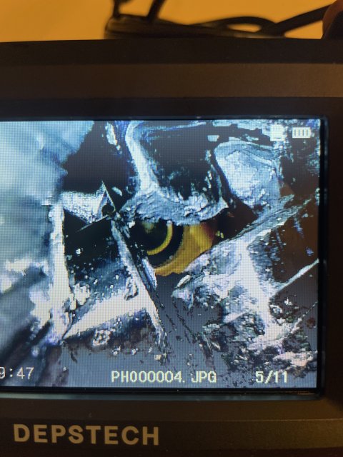

Onto the good news UPS manages to only fuck up this order half way. Another Diff was shipped, had very distinct this side up arrows and then was reboxed upside down and fucking diff fluid everywhere. After some simple green abd brake cleaner she cleaned up nicely.
this unit is used, will get flushed and then boroscoped, this will be my backup.

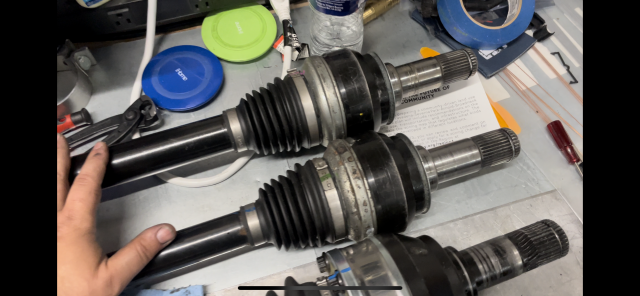

RIP 3.09 you came to me way of Mike Starck and gave me two good seasons.

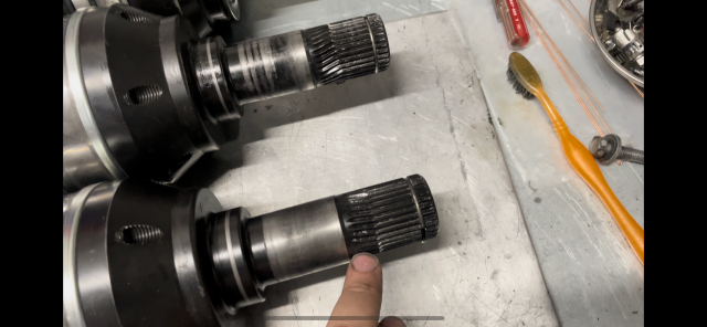

theory of a competing hypothesis did the diff break the axles or the axles break the diff…
both axles are twisted at the splines completely ridiculous as ive had multiple 9.6 passes on my demon axles and they look fine.
IMG_7135.png Broke pieces of shit
good news local guy near me was shooting the shit with me and offered to buy them. He makes his own stubs out of hardened materials. He also has dynatrac pro 60 in his challenger and twin turbos, he can have them. Full video coming soon when I get the install done. Will be pulling the hd images off the bore scope and posting soon. Im out back with doggo downing a beer
