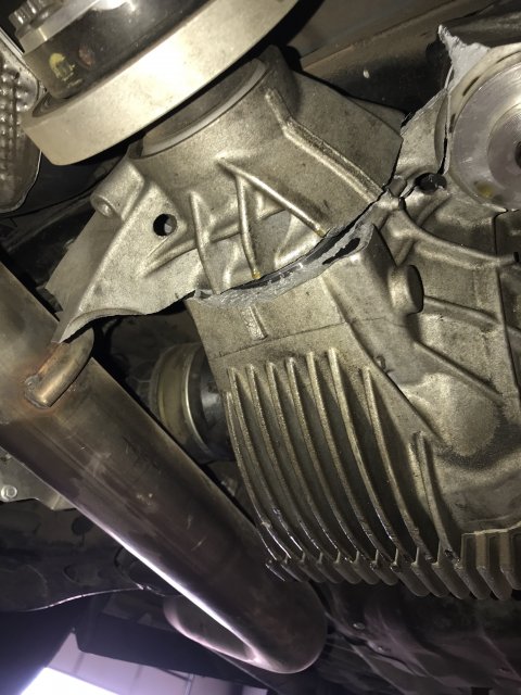

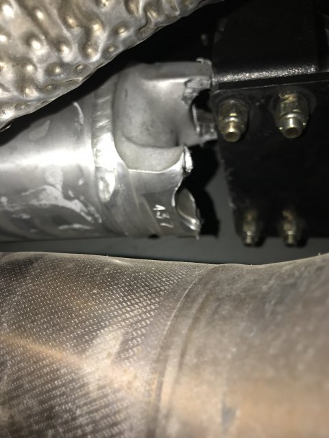

One of the shop Hellcats made a mess of the starting line in Vegas last month. This one has the full AAD with diff brace and lockouts. Also broke the driveshaft at the front. Have to wonder how the trans liked that. I think this would be a argument for that billet rear or a 9” conversion. 11901D3D-4706-49E7-872C-DC0B0EBDDC44.jpeg 3AE10394-CA45-4EA4-B1D2-10F65F532DC6.jpeg 359AAD75-8B08-4EB8-9F6E-914C07E713F4.jpeg
