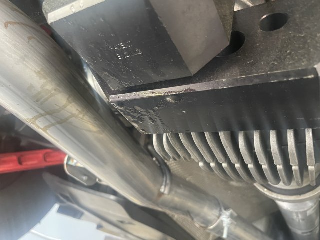

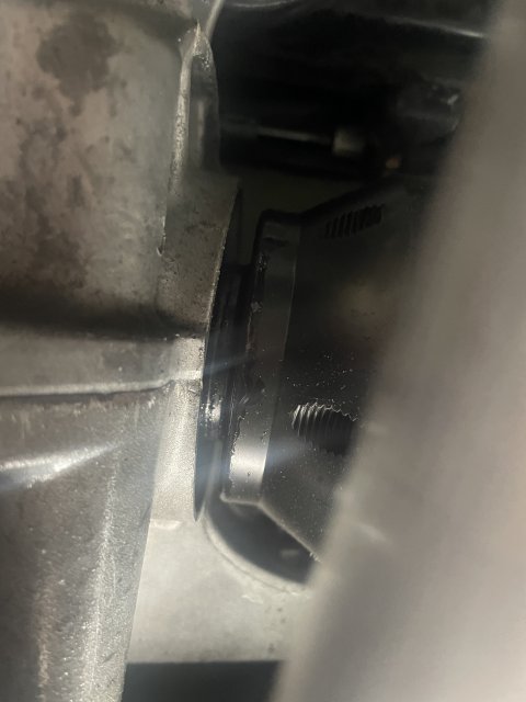

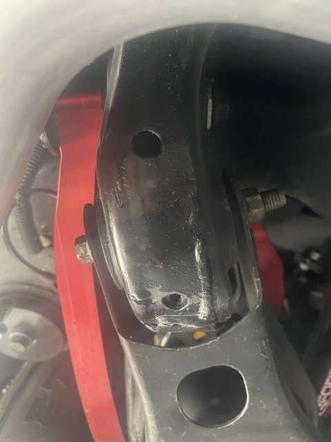

RIP diff, you will be missed. Based on the fluid Im either guessing the axle broke or the diff shattered the seal. Place your bets below on what it is. Ill post a teardown around 3PM today. Under the car doing an autopsy as I type this. Also, am I fast now?

My bet - broken axle. You were able to get it home?

Broken seal on the pinion

Yes, exhibited symptoms of crunchyness when making left or right, when making a right into my garage it went boom... Gonna look for the ring footage now.
