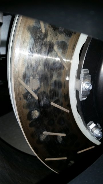

Z26s on O.E. rotors used for the Colorado Mile.
Oops.
