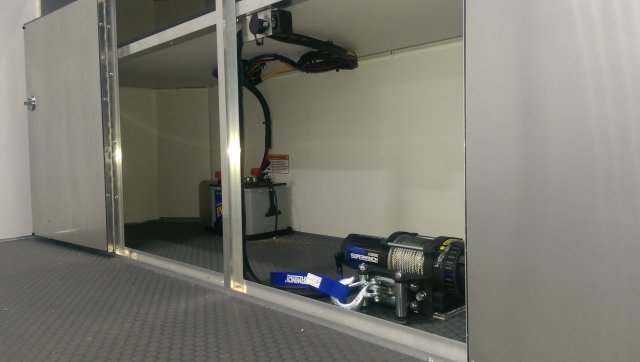

Parking brake? Lol. I leave the front attached to the winch and ratchet strap the rear until tight. You will find that after some travel, the straps will loosen up some. Every so often…. I stop to check and just a touch of the button on the winch remote forward tightens it right up.
I didn't even think of that benefit. So you don't even tie the front down just leave it on the winch?
6,786
12,623
Hey, it's one of China's finest winches (surely it just happens to be very affordable despite its superior quality).
But what scares me even more is the Chinese synthetic winch rope. This after recently have read up on those, before buying one for my Warn winch, for a trailer.
And that winch will NOT be used for holding anything in place. It'll be there for getting inoperable vehicles onto the trailer, which will then be properly tied down.

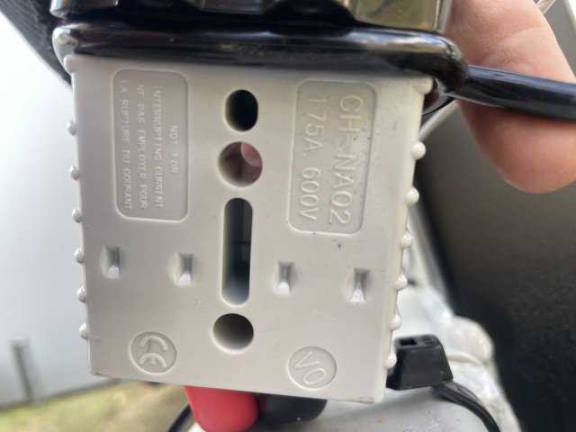

Tested winch, rock solid. Getting the front to rear charging kit as the flat four, won’t give it enough angry pixies. Bus bar for battery already in place.
The following connector goes from the front of the trailer to battery tray.
From what I can tell this was a cannibalized 1500 amp jumper cable set. They run about 60 on ebay. Theory is undo the nuts on the clamps and attach to truck battery up front. Would run it along the left frame rail and route to the hitch from there leave some extra feet to cross over, when done i would fold the cable and store in the underside. The wireless remote is nice!

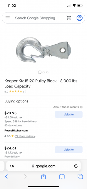

Or, buy an inexpensive snatch block and you'll have twice the pulling power, and at a slower and more controllable speed.
5,068
17,058
If I need more than 3500 lb pulling force to get it back in the trailer, It's probably going to the junk yard or is totaled. Sometimes you need to cut your losses and walk away [rant]
A pulley on your cable like this @TraxMoe will double your capacity. It will shorten your cable by 1/2 because you have to attach the hook on your cable back to the winch. I used to attach it to the winch mount but you’ll have to figure that out. The pulley (often called a snatch block) is hooked to your vehicle. I used to have to extend the snatch block with a tow strap because the doubled up cable was too short to reach the front of the car. You may have to pull it up part way and remove the tow strap and reconnect the winch cable if you have to extend the cable to reach your car. My old Superwinch came with a snatch block for the purpose of doubling the capacity if needed. 127B7FCE-6E17-4D83-9393-5A6725CA3B6B.png

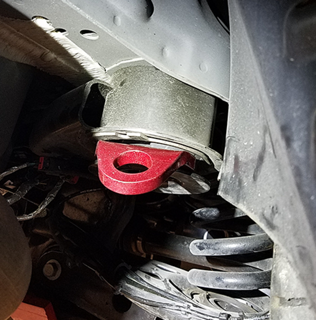

Also Im assuming the car would still pull in straight mounting on the sides like this? Or would you have to hook to both right and left sides to pull in straight?
It would want to turn to the side a bit, unless the winch is offset the same as the tow hook.
But it's easy enough to move the pulling point of the winch with two snatch blocks. Or just one, if letting the fairlead take care of the first 90 degree turn.

This Is for front and rear. But Id be more interested in the rear I think
TBA Machine Bolt On Tow Hook (Demon/Hellcat) HC-TOW-HOOK - Beefcake Racing
Im looking at these as well. The fronts would be attached to what they call a bridle, https://www.macscustomtiedowns.com/collections/all/products/bridle-121936, rears would also use this. What in worried about is if it will push up on the front splitter or damage bumper. In the rear I have the cradle lockouts so adding another shim in there is ot something I want to do. I have seen people use the hole on the spring link.
4,383
10,906
I think that's the route I will go. To avoid that. may have to get the front tires on the ramp.
