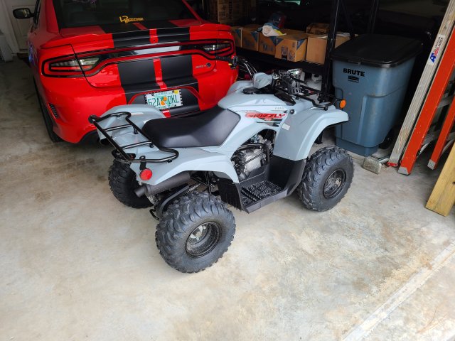

How are you successfully tying down your cart? I'm having a tough time getting my atv to stay put so I'm not taking it.

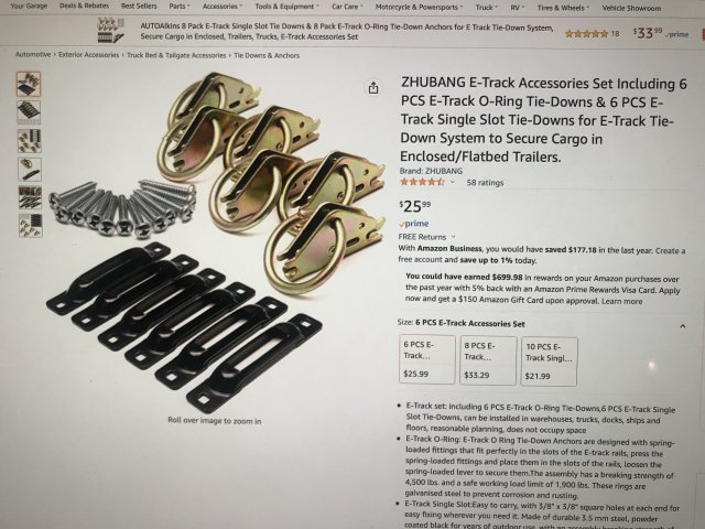

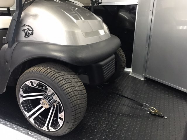

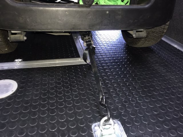

E-Track. It’s a tie down system commonly used in trailers. The track fastens flat to the floor and there are a bunch of different attachments to be used for securing stuff. You can put it on the floor or walls. I just used the single attachment point but you can get in strips with multiple points. D01244D4-CAB1-412F-9B78-E6C8BB9FC61F.jpeg 264C10BF-9455-4D3A-B0FB-1664E4649D48.jpeg F63E58A6-9CE7-4D82-828D-A62DFBF710C4.jpeg 1FF6020F-B8A6-46C4-920D-FFDBDCD9D689.jpeg

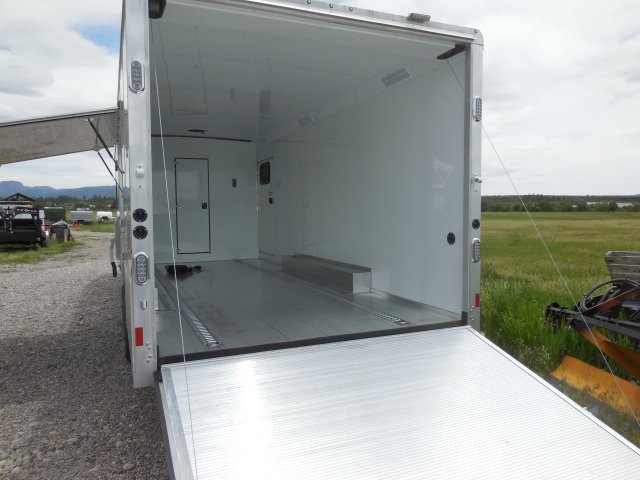

For the most part I use that kind of setup, largely because on the flatbeds all I have for anchor points is the stake pockets. In the toy hauler I have E-track and can use wheel nets or tire straps.
The latter are a little more work to use, but there's nothing touching the wheels, which is nice. Either way, I never tie any vehicle with suspension to sprung parts, only to axles, wheels or tires. DSCN2683.JPG

I have the hold downs installed in the floor, just need some type of straps that go over the wheels with a single point of attachment to the holddowns.
The suspension has so much travel that attaching to the frame it won't stay secured, especially on rough roads.

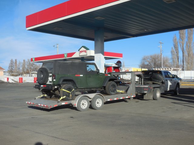

Look into lasso straps. Inexpensive and effective. As seen on the rear in this photo. DSCN3115.JPG
