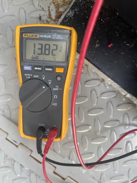

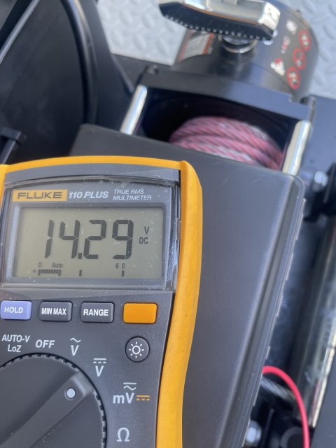

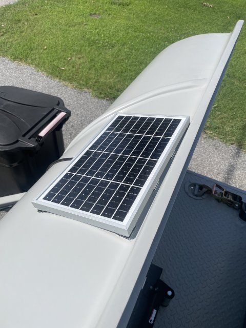

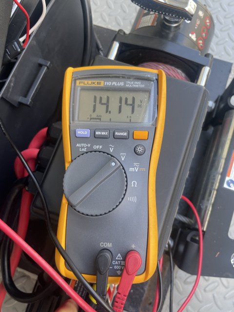

@BULL @Jimmy N. @Unholy707 I apologize, had a wiring issue. Didn't pull enough sheath off when installing in terminals.
power from pv array
power going to battery
battery power
also in direct sunlight
power from pv array
battery power
