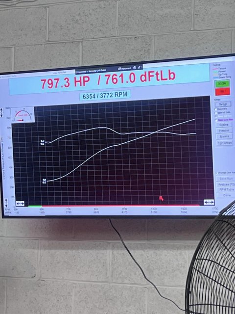

Made 797 on a basic ass tune, no shift point changes. 1300cc, 2.72, dual pumps e85.
Take a look at the torque line, see that dip? We can replicate the infamous fall on face feeling and tune it out immediately.
We have a revision coming soon. Was also a teaching lesson for Matt how to use the dyno.
