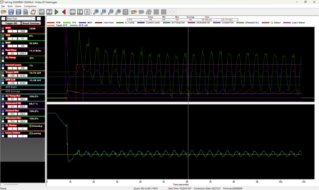

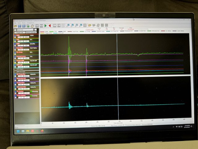

It's not much but I got the idle dialed in way better. A wise birdy said to inspect my throttle cable so I did and it was too tight. So tight it was idling at like 1800... Yeah that was not fun to deal with. The graphs are looking better. I don't have an IAC so getting idle dialed in is going to be fun.
It's very different than tuning my Hellcat that's for damn sure.

Sounds healthy! Mine was swinging like that (I know stock pcm) because no transmission was selected. Chose transmission and fixed it (while still m6), obviously different ball game with Holley. But basically it didn’t know what to do or what tables to use because it didn’t know any transmission was connected
8,770
7,693
Drove fine, but always hunted like that at idle

All research on the Holley forums suggests its lean. I will try enriching it when I get a chance to tomorrow.

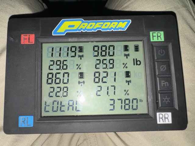

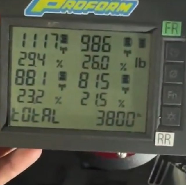

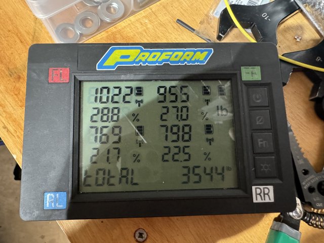

Test one.
Test two.
Also studied some of my holley courses online and got idle dialed in. Compare this with my idle from before.

Much better! Looking good man

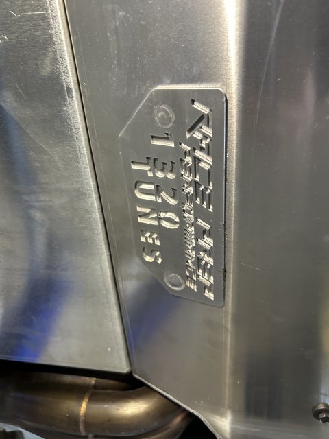

Also I am the first to have a pan for a TH400.
hopefully i will never need em

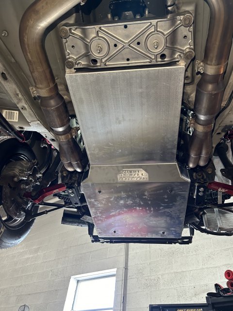

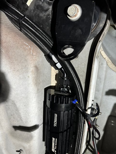

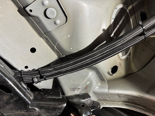

@MMissile rerouted as yeah tech will fail me. Ordered a rear seat firewall from RPM.

Been thinking about one of those belly pans. Fire extinguisher is my n the list first though
4,146
10,435
Thread Starter #599
@Unholy707 They are a good idea if you continue to push the build.
8,770
7,693
Oh I am, just may take me 4/5 times as longer as you guys lol. Hood getting painted next week, can’t wait to see how it turns out. Then back to performance stuff
