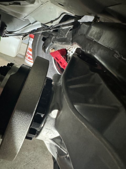

Kind of disappointed car wasn’t ready for MSHS. Time/energy/money are at an all time low so its been a slow process. However the R&D continues.
This casting mark is where the hall effect sensor will have its bracket mounted. Million dollar question whats behind it?
just more aluminum, drilled and tapped for m8x1.25
Appropriate depth
In between flange wheel and case is where a 16 tooth reluctor wheel will be mounted. Split collar. ID of collar is 2.5” IMG_4523.jpeg
Thickness of split collar is .375”. Plenty of room. IMG_4526.jpeg IMG_4525.jpeg
Went with low doller motorsports. 5/16 sensor due to space requirements. The Holley should be able to derive MPH and this opens the door for traction control. Easy day.

R&D continues. Very pleased with the reluctor wheel.
IMG_4592.jpeg IMG_4586.jpeg IMG_4591.jpeg IMG_4589.jpeg IMG_4588.jpeg IMG_4589.jpeg
