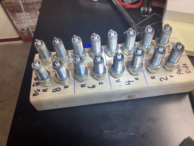

I ran NGK 6619 gapped to .028 in the old car. I might have gone to 2309s too hard to remember now.
When I need to swap plugs I'll probably use 2309s at .028 but not gonna fool with them until I need to. Car is running well as is and I'd be more worried about causing a problem. I've seen several gave misfire issues after plug swaps and it turn out they damaged a coil during the change out.

Been running NGK 2309’s since my first pulley on the car. .028 at 16 psi, .025 at 20, and .022 now at 24-25 psi of boost. These plugs had about 1000 corn miles on them when I put the Whipple on, they went back in as is with the ported heads and now running the 2.4 at 21-22 psi still with the .022” gap.
love that idea! ill be making one of those blocks soon!
