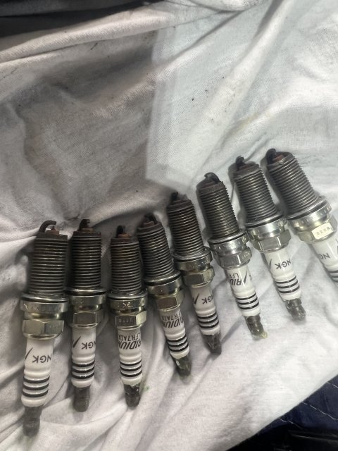

Replaced mine last weekend. These have about 1000miles on them. All still gapped at .022 lived from 93 to Q16 then the switch to E85. they still looked good, after some very hard miles on them. 73377732-D12D-4F61-8C43-299ACB116CF4.jpeg

Replaced mine last weekend. These have about 1000miles on them. All still gapped at .022 lived from 93 to Q16 then the switch to E85. they still looked good, after some very hard miles on them. View attachment 97040
Yep look good and so did mine. But I had a stock plug in bad shape when I changed it so I told myself I’m going to do this yearly.

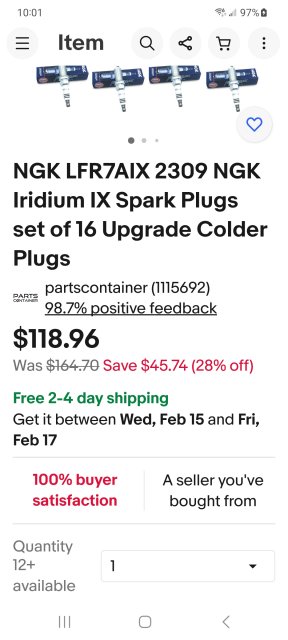

Hey Marc that would make me think twice about a yearly plug change at that price
Thought it was 8 plugs but see it is 1
3,633
11,722
I'm seeing 16 plugs for the $120 range if it's the right ones.
3,633
11,722
That’s for sure. 😂
