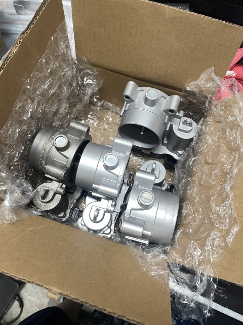

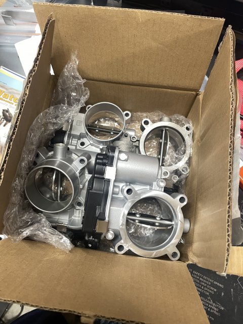

You sure it was the throttle body and not the S/C bypass like I was sucking closed? Did you get the red lightning bolt of doom. I ordered four of these fuckers when scrambling and they never came in… then one magical fucking day BAM! and have two used ones. Gear Head Fabrication makes the Badass Bypass Valve. Recently was logging at 20psi and the bypass called me a peasant for not making more boost.

From what I see going on it was not the bypass.

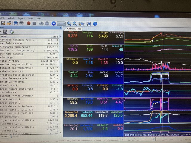

My stock bypass is holding up to 25 psi of boost. As is twin 295 fuel pumps and stock 2016 fuel rails. (With my personal mods done to them, fuel line, and in tank connection)

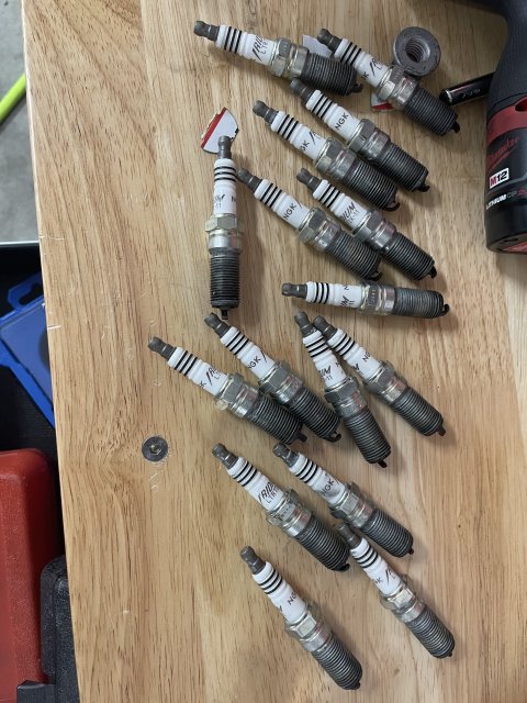

Everyone’s friendly reminder to do spark plugs or at least check them.
I’m putting brisk 12s in View attachment 96967
How often?
I'm hearing that many name brand plugs are defective.
Some leak compression through them. Makes me nervous about changing.

Well I don’t know anything about that.
I like to check at least yearly. I skimped on the leak down this year. But it may be overkill. I’d hate to guess what a shop charges for plugs

Proline has been having problems. They developed a spark plug tester out of need.
Mine are almost at 2 years. 90% track only?
The problem gets to be the gap when adding boost. But plenty of people have done it with stock plugs at your boost. But personally I’d at least do an ngk plug happed to .026 or .028 at your boost.
