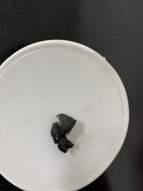

Undoing the dss drive shaft and When I’m taking the bolts out this goop is falling out. Is this a worry?

Is that normally where they break?

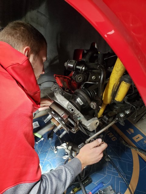

I went over and helped get the axle out and brought over a stock axle so he could get it running.
Jon assessing the situation
Yes, what normally happens is the diff breaks & then the axle goes when the diff internals lock up. That's why I suggested dropping the diff anyway to begin with.
I think someone mentioned that already :unsure::whistle:
#91
No, I said if it comes out in pieces,, it's broke.
Thanks for the help I should have pulled out the 12mm Allen originally….
