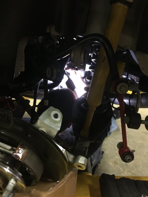

So my tips for anyone who has not done axles on a car.
Obviously disconnect everything. Sway bar link, control arms, trailing arms. Take the caliper off as well. I zip tied it up so it didn't dangle.
There's a 12mm bolt with a nut on the end. Take this out!!! I saw a video online and they said they didn't have to do it. Well that was my hold up all morning and my struggle once I took that out came right out.
If you end up taking the hub off I had to hit it with a rubber hammer.
Don't pry against the axle. I didn't know it but new axles don't come with that end piece.
A screw driver was enough to pop it out of the diff.
After doing the driver side and struggling the passenger side only took me just over a half hour.

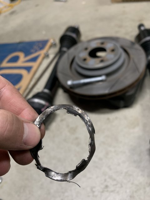

Is this needed. I prayed on this side
58,918
203,471
I'm sure it did but we were not prying at that end so they would not have been damaged
4,897
16,518
It’s a spring retainer. Not a washer.
We just called a washer. It looks like a retainer but not sure what it is retaining

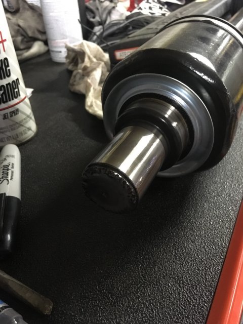

My buddy snapped an axle in his M6, same exact place yours is. His diff survived. FWIW.

I'll ask again, did you get that piece of axle out of the diff. ?
58,918
203,471
not yet
58,918
203,471
There have been enough broken axles but there are no videos on how to get it out. Jon said a rod would have to be no more then .25 to fit in there to try to tap it out from the other side
