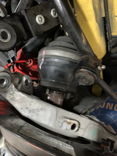

Are the rear brakes back on the car?

No one caliper is off
That's what I saw in the pic. You have to be able to stop the driveline in order to shut it off. On the ground as long as the car is stopped and the DS isn't turning you can shut off.
If you pushed the brake pedal make sure the pistons in the caliper that is off are still in.
The reason the driveline has to be stopped is so you can put it in park. The car will only shut off in park.

^^ yeah, don’t touch the brakes anymore, you’ll f-up the caliper that’s off of the car. Or stick a block of wood in it.

jon sent a pic he can't get it out of the hub

hoping a better pry bar does the trick. I have a fair amount of tools but as young as I am the collection grows over time
