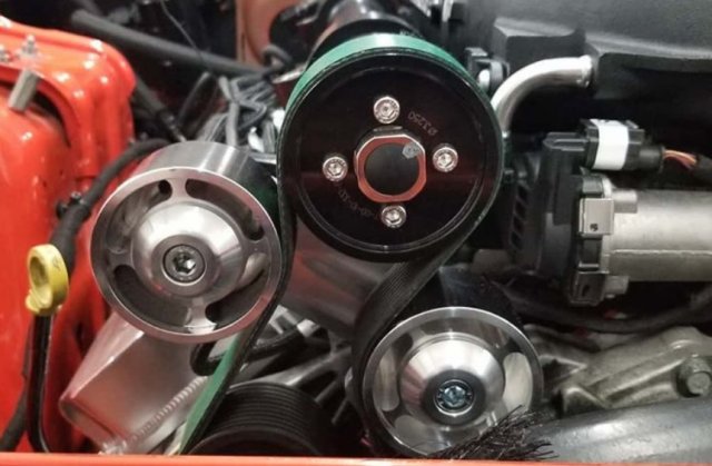

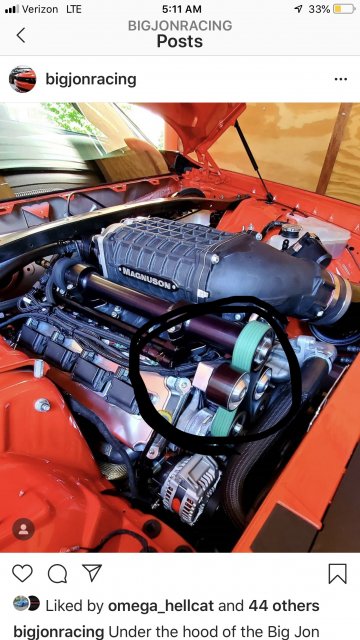

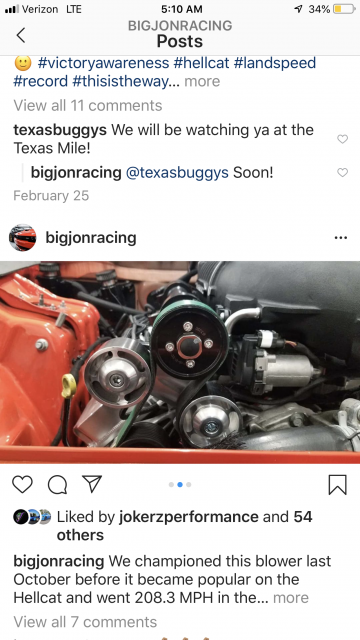

Well woke up to some good news. This set up might be available to purchase soon. They are quit a few requests for his custom bracket and pulley set up.
I told him that I’m first lol. 7C257E3A-52AE-4B05-A062-D822480EA37B.png AD3FE315-F798-4C84-97E5-EFA0527600DA.jpeg

You need to crop your pictures! That dual idler setup is as trick as it gets. Magnuson...Wake up!!! 250C1440-35BC-49D4-8ACC-47D2CEEEA99E.jpeg
