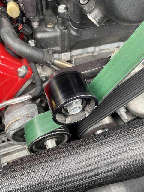

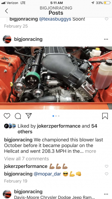

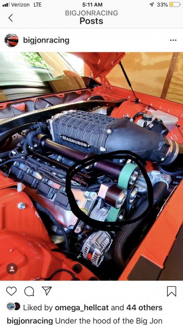

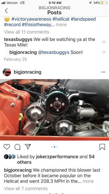

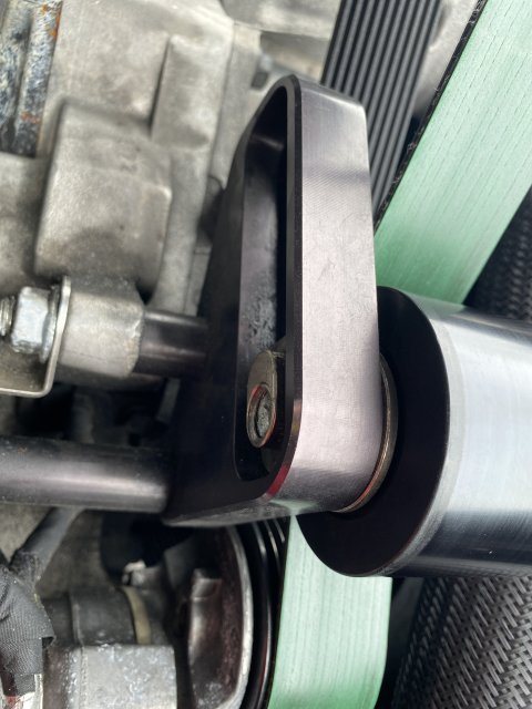

Has anyone seen a set up like this? My main attention is to the bracket that was made to hold the 2nd idler pulley in place on top. It helps with a lot more belt wrap as you can see. I was able to reach out to the 2 shops that have done this with there big builds running the magnuson. I’m finding out that with 1000hp plus to the wheels running the magnuson I’m not the only one experiencing a lot of belt slippage. The 2 shops will not be making anymore of these. I have made numerous calls to almost everyone including magnuson and no answer or help. This is turning out to be a big issue for Magnuson. They need to develop a bracket like this if they wanna keep up in the SC Mopar world. I did talk to Jokerz Performance and they are all in on making a bracket for me but they don’t have access to a Hellcat right now to get the correct dimensions. I did chat with bigjonracing and he had all the same belt issues I did till his shop made that billet bracket for him. C3D0CEB4-E8AE-426A-998F-09E18AE75A82.png 7C9027F3-D230-4A6D-A90C-0FE8BA9D9006.jpeg B660C26E-8F6A-495B-AFA7-800D51BB4E57.png

That might just work. I wish these shops could just give me the dimensions & blue print of it. Jokerz is ready to make them now and use my car for r&d.

I’ve made so many dam phone calls and it seems to be that only the Hellcats that are pushing 20-25psi+ & over 1000hp rwhp are having this issue.
I’m thinking Tommy at SRT AutoWorks And jokerz Performance will be 1 of the 1st to develop and solve this issue. I’ve given up on Magnuson. There is multiple shops that are experiencing the same issues but have developed a 1 of a kind bracket and pulley to solve the issue.
Not the one to talk bad about any vendors or shops etc.. but No help from Magnuson. Lol
