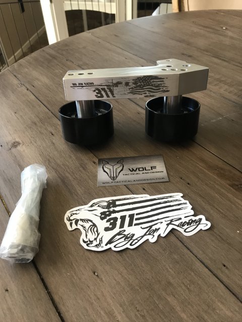

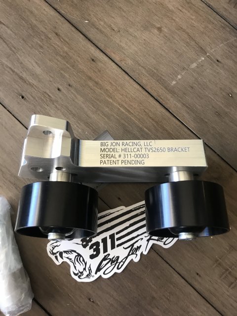

Yes. Just found out yesterday the dual idler pulley has been shipped. Should have next week sometime. 76B15A21-4664-42AE-B90E-152815D601FD.png

Should be back at the shop in 2 weeks for install and hit the dyno again. This set up by BigJohnRacing guarantees no belt slippage with the Magnuson.👍

This one is mine. 1st one to get one. 🏎🏎🏎🏎

What are they charging for that? From my research some other big HP guys haven’t had the need for it. Wondering why yours was slipping.
650$ I’m not the only one. There is about 6-7 of us including bigjon running the 426 stroker and over 1100rwhp on the magnuson experiencing the belt slippage. Now a stock 6.2 with the magnuson pushing about 800-900rwhp no issues.
Ripatune and Gear Head fabrication experienced same issues pushing high hp numbers.
I believe it’s a flaw and poor design in the magnuson sc. lol it’s been a pain in my ass! So in 2 weeks install and tune on the dyno just to see if it works. Right now on the west coast it’s gonna be 121 degrees tomorrow 😩 so I will return in the fall for the big bad ass winter tune by TB and Tommy.

Wow, $650, fack. I thought Ripa's tensioner was designed to benefit Maggies. I have it as a backup with another pulley for my current setup.

The problem with this Maggie is what works for the over 900whp combinations hasn’t been established like it has with the stock superchargers. The Maggie’s have that overdrive cog setup (that was recommended by them in this case and I think is part if the problem). Along with the overdrive ATI, it is trying to accelerate the supercharger faster than the primary pulley can handle without more belt wrap. This new Big Jon idler is a masterpiece. I’m actually surprised that it isn’t more expensive. One of the problems is..... others sort through this kind of stuff and never share what it took to get there. They produce the end results and keep whatever secrets they figure out to themselves. What you’re seeing here is the good, the bad and the ugly of being off the charts. Once all this is sorted out, then those who follow get to go straight to the established combo. Easy peasy
I was gonna go with the Ripa’s tensioner then I saw bigjonsracing design and I was like I need that. My mistake it was actually 695$ not 650$.

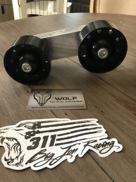

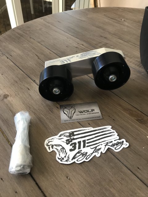

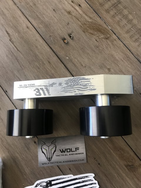

Update update lol it’s finally here! Plan is to hit the dyno next Thursday & install the day before.
DDBB562E-2F51-4DAB-AADB-6C2B47C7AADD.jpeg 74528DDF-5148-4629-8FE0-C9F80CAAA88B.jpeg 8080D689-A782-4DF7-BDEC-A5F143481120.jpeg 8080D689-A782-4DF7-BDEC-A5F143481120.jpeg 39DE9BDD-954B-4423-B110-866F340BA8B2.jpeg
