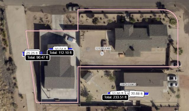

LIFE CHANGING EVENTS: 8 Months ago my Dad left this earth and left me some money. So, now I am leaving California and moving to Kingman AZ. It's kind of scary and will be a huge hassle in some respects, but sometimes you just have to go for it.
I am going from an apartment, where each time I trailer the Car it is a logistical nightmare, to being more on my own timeline and much more convinient. But, I will be trailering EVERY time I run the car from now on. Vegas 125 miles, Phoenix 210, Irwindale 310, Bakersfield 360. They might build a Drag Strip in Yucca 32 miles away. Just rumors at the moment. FCA Proving Grounds is right there. I am right on the 40 and this will give me a head start going to the mid west and back east and is a couple hundred miles closer to Houston/Dallas.
Also the Car will be safe inside with plenty of room for everything, AND the Truck (30X60 additional Garage in back). RV/Trailer parking has to be poured but it is setup for it (useable as is) and it will be generous in approach and length.
Escrow closes July 8th. Wish me luck.

Very cool Ron:)

Congrats Ron, you will enjoy Kingman, kinda centrally located for your runs...lifestyle is more laid back than anything the city has to offer.

good for you ron get out of that communist state
