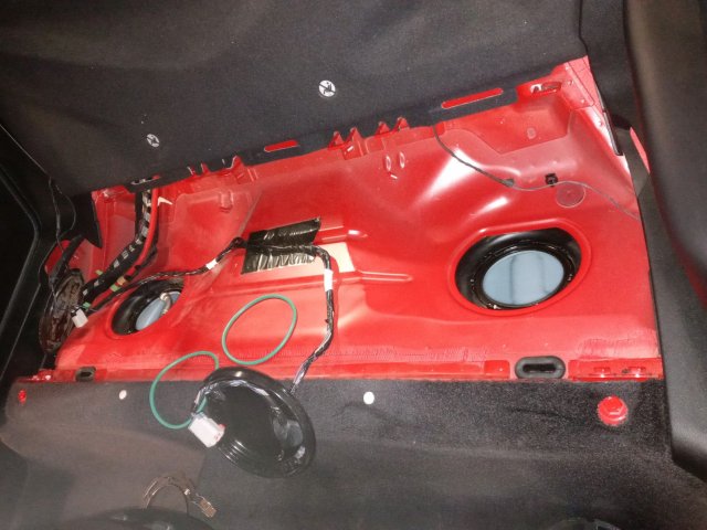

OK, so I just finished fixing the car. The Fuel check valves or foot valves in the fuel pumps were bad likely from running a Mix of MS109 and Methanol. My one friend has run Methanol several times with Sonoco GT 260 and had no issues so it might purely just be these 2 fuels mixed that did the pumps in. Just to be clear they still pumped plenty of fuel/pressure according to data logs. I bought a complete RedEye fuel pump setup from @16GoManGoHC2 . Then while I was waiting for the stuff to show up I went on Mopar TSP and researched the Demon/Redeye dual pump fuel system. As far as I can tell the two cars use all the same stuff (Part numbers) now. His stuff was slightly different in a couple areas but it seems to pump better. To be clear the Demon stuff supersedes to the current Redeye stuff.
OK shop manual says if rail pressure falls too fast after shutting off car: Replace fuel pump module, or replace leaking fuel injector. So, only 2 things it can be other than something obvious like a fuel line leak etc. When I would shut my car off the pressure would go to ZERO instantly.

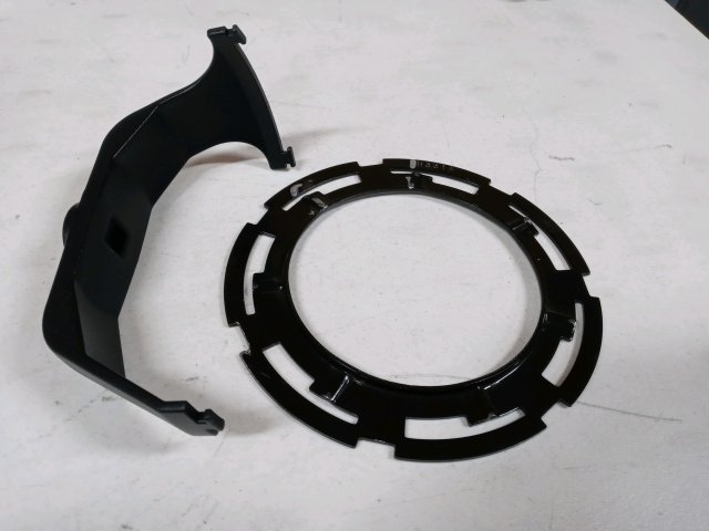

I highly reccoment you get the lock ring tool. I bought this one from Amazon for $20. Use a breaker bar to turn the lock ring with this tool. It helps a lot if you put turning pressure with the breaker bar and then smack it straight downward with a rubber mallet a few times. Also you can use the tool with your hand to start the lock ring when reinstalling the pumps. Position everything just right and then push down and turn!
https://www.amazon.com/dp/B07F9MJV4J?psc=1&ref=ppx_yo2ov_dt_b_product_details
You also need a tool to remove the main fuel line. Line is exactly .500 in. But maybe not..............
The ONLY reason you would remove the main fuel line is if you have a bad level sensor on the right/Pass side of the car. There are NO fuel pumps on the Pass side. Pass side is only a suction stand pipe for the jet pump in the Fuel Pump module (it's on the drivers side) and possibly a relief valve for high pressure and the level unit/float. Pickup/Level unit PN 68412551AB as of now. Leave it alone!

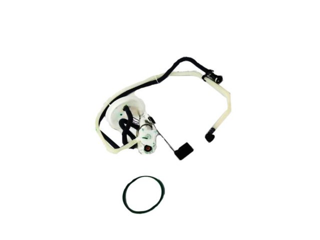

Drivers side is the Pump Module. PN: 68445257AA as of now. It includes a level unit and 2 fuel pumps and a Jet Pump to scavenge the fuel trapped on the Pass side. When I pulled the car apart the Pass side was dry. Of course I will never do that again. So, 2 Pumps. One is a Primary and they other one is the #2, or B pump or secondary if you want to call it that. The Primary pump runs the Jet pump by taking some of it's output and discharging it through the pump/jet. When you go to idle the #2 pump shuts off. But the second that you touch the throttle to take off, the second pump starts and it runs at the SAME pulse width command as the primary. They are not staged or staggered. They run the same speed. If something goes wrong with the pump or wiring the bad pump will either default to 80% limp mode or shut off. The only difference is the Primary pump will keep running no matter what because it is needed to scavenge the Pass side of the tank.
The 2 pumps look identical. The second pump even has the output for the Jet pump but it is not used.
The 2 level units are interchangeable and they appear to snap in. But the Floats are NOT interchangable.
Changing the Pass side PU/Level unit is a bitch because you have to fish those intergal fuel lines over the hump and across the tank. So don't. One line is the suction line for the Jet Pump and the other line is the output from the Main Fuel pump Module crossing over to the Pass side and then out to the front of the car.
Changing the Drivers side main fuel pump module is not so bad. But I reccomend you get the tool if you have time and I reccomend you get a new O Ring. Mine seem to have swelled and were a little too big for my liking. So, hoping they seal properly over time..... 0222231612.jpg 0224231840.jpg 0223231333 (1).jpg

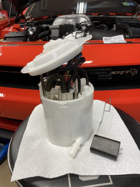

Main/LEFT Fuel Pump Module/KIT..... 41D4ABB6-5343-4BA5-B7C0-ED7A91A575D3.jpeg

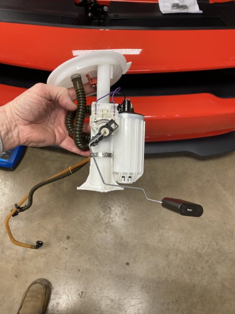

RIGHT PU/Level unit. CC2AA2E8-9B6E-4FE8-9971-9B88DF1D81B3.jpeg PU LEVEL UNI.jpg

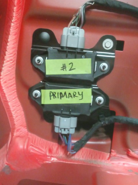

In my Hellcat tune, "fault" causes the pump to run at 50% DC if memory serves. I think I logged that back when I was fooling with mine in the JMS.
Good to know additional FPCM just mirror what the primary does. That's exactly how my drop in system works.
