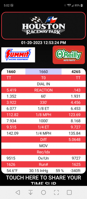

So, lets talk about where this stock Demon record is going. I think there is likely a 9.44 or 9.45 in my car based on the 9.503 run incrementals. But the car had plenty of hiccups on the 1-2 and 2-3 shifts. I kind of expected this based on what was happening at Irwindale when the DA was lower. So, take an extreme example with the stock calibrations in the PCM/TCM. What if you could get the car weight down to 800 pounds race ready. It would over rev severly every time with 840-900 HP. You know this and I know this. So I am pretty sure we are at a crosroads for the stock tune Demon Record. In fact I ended up resetting the PCM and TCM adaptives with the HpTuners Scanner program. It likely would not have made good passes in -1000 DA without doing this. I am not 100% sure because I reset them twice and the immediate result was not consistent. So I cannot say with certanty if it helped or not. Also on Sunday the DA was +600 to +1100 feet on all my runs. On that day there was not one hiccup. It did run 9.52 at +1100 feet. Also proud of that.
There is ONE more thing I want to try. So, I am hanging around for Brian Masons private track rental at HRP. He moved it up one day to this Friday because of the weather. And I think the conditions might be favorable. Maybe very similar to the conditions where my first Demon did it's PB of 9.550. So this ONE thing is to change the relationship between the Engine RPM and accleleration rate and the actual road speed of the car. A TALLER TIRE! The car will move faster and farther down the track and the motor will accelerate slower. So, maybe in some really good DA, I will be able to leave the adaptives alone and let the car run!
I have the lightest setup as far as a 29.5" tall tire. Hoosier 10.5" DBR 3/4 worn on a 17X10 Win Lite. I am going to get there early and swap them out. Maybe we will get the 60 foot comparisin @Speedy! I should be able to make lots of passes and I will give it my best........

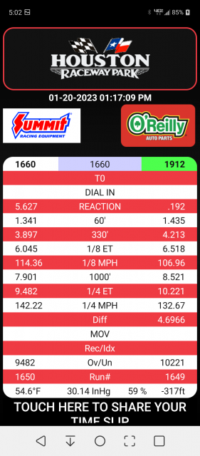

OK, Brian Mason's event went off. Some sprinkles and then about 15 minutes of rain but it eventually stopped and they dried the track and we got going. The track personel are some really great Guys. They did a great Job.
I like these taller tires. I think they showed potential in possibly going a little quicker if the conditions were better. I ran a 9.48 and the conditions were not all that great. It was the second pass. They used me as the initial tester. No body wanted to run first because of the rain, so I sent it. No time slip of course. So, fully warmed up and I did not have to wait too long but I could not loop right around into the bleach box either. Would not have mattered much because the power chiller was not enabled. This car is stingy with the chiller and it's so frustrating. There is very likely .02 in the sixty and more than that in the final numbers. But 9.48 without it @ 142. Dang, I'll take that. Last weekend the 9.46, 47 and 48 ALL had the power chiller on. So I likely would have matched the PB in worse DA. But I had to abort a couple runs because of the Hoosier Death Wobble. This set is the worst. The first runs did not do it. It defies logic. This set even did it a lot at Irwindale and that is rare to do it in the 1/8th. Anyhow, ran 142 a few times today without the chiller. In fact it never got warm enough for it to come on. 9.48 MASON.png 9.51 MASON.png

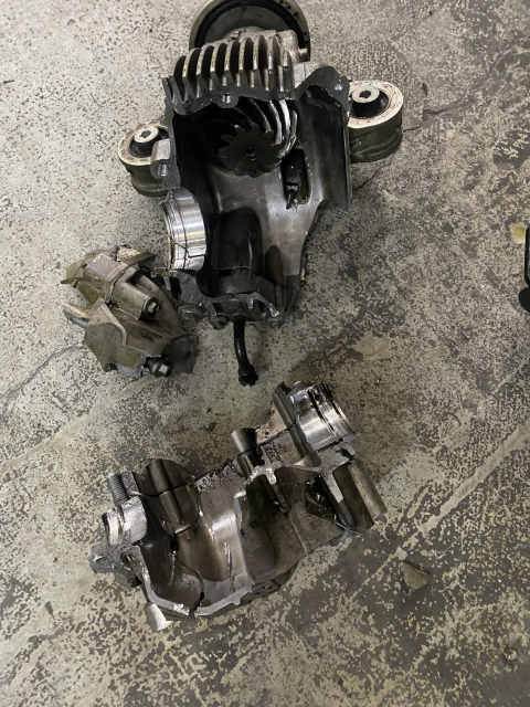

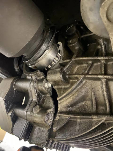

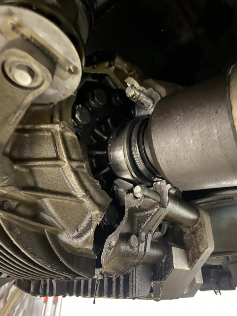

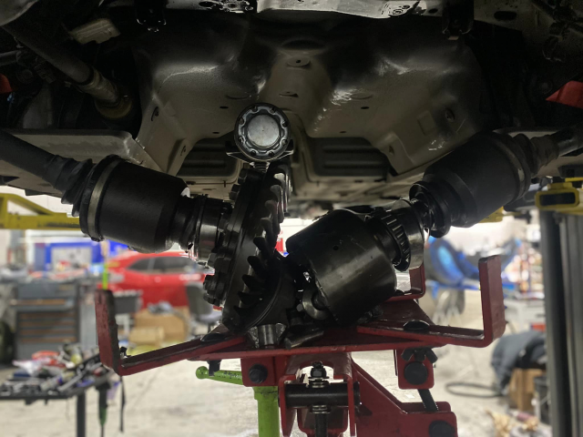

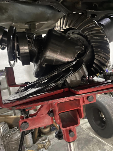

Did any rear diff housings let go this year at
Legion?
60,208
209,915
Legion?
Yes. Sumit Goyal split his in half. Saw pics the other day
60,208
209,915
