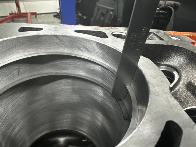

getting started. Rings are filed. .028.
block needed honed to fit pistons that are made for the bore. Funny how that works.
New block had a taper in the bores that needed fixed or would have had tight pistons.

Yes, a
Yes, this has been a finding on multiple new blocks (@fumanchu182)

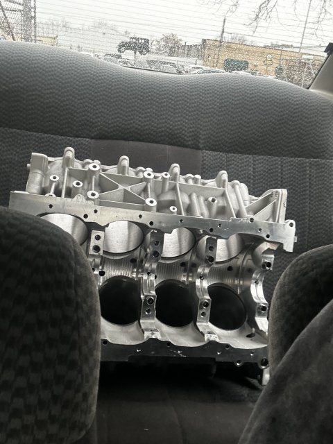

This is a hellcat block can’t get a red eye one over the counter.

I did not ask what cylinders sorry.

is there even a difference in the blocks besides color? Figured they’re all made on the same line and tooling

Just color is it.
I have 6 blocks at the machine shop right now picked up 2 yesterday with my grand am.
