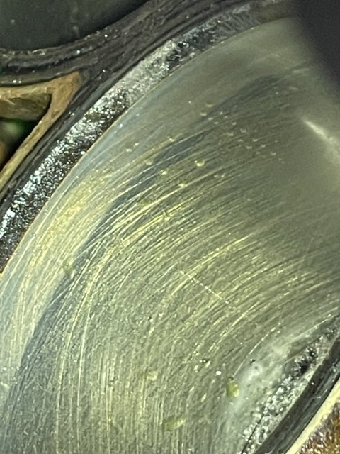

Well got Cody’s engine. Found block junk and cylinder across junk. Number 2 had rust.
3@4 both look like not broken in looking at cylinder walls. This is NO WAY a tune issue. So people can stop with that.
it’s a injector or a piston ring problem.

What’s wrong that would make you say the cylinder didn’t break in? All mine still have cross hatch
5,492
4,526
or are you saying the smooth one is the rusty one (rust at the top). Do you have a regular hellcat posting you can compare side by side? Want to test a theory
3,351
6,687
I think a regular HC would look like that in cylinder 7, right?
Just the wear on the cylinders it self. Does not look like the cross hatch is worn almost at all on 3&4 and the rest do.

Do the cylinders have to show wear? All 8 cylinders in my 5.7 looked like this when I replaced the cam at 187,000 miles and I just went over 200k
