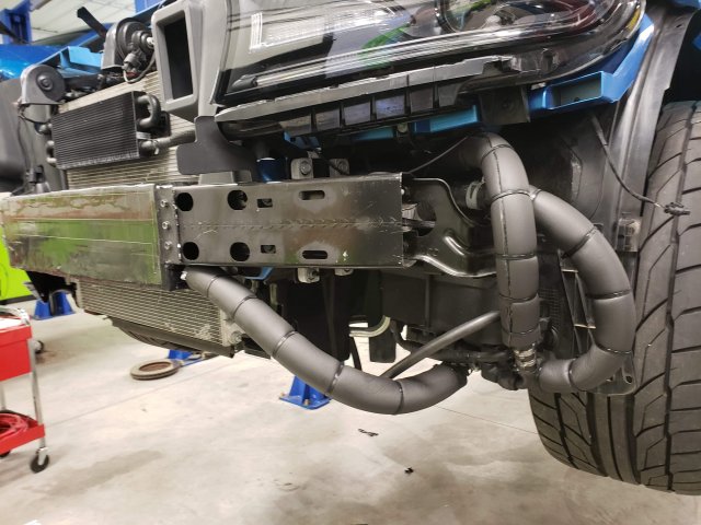

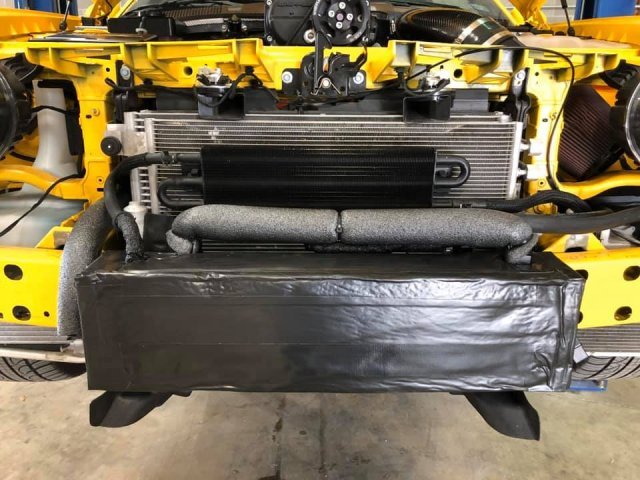

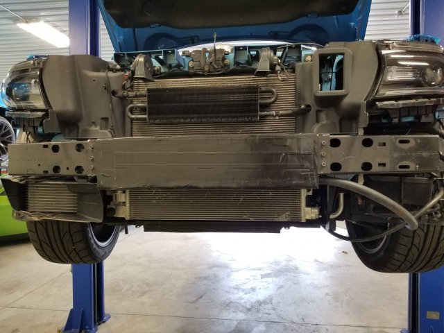

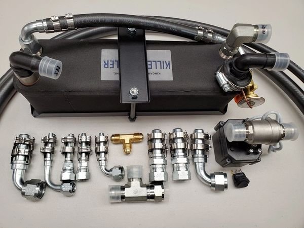

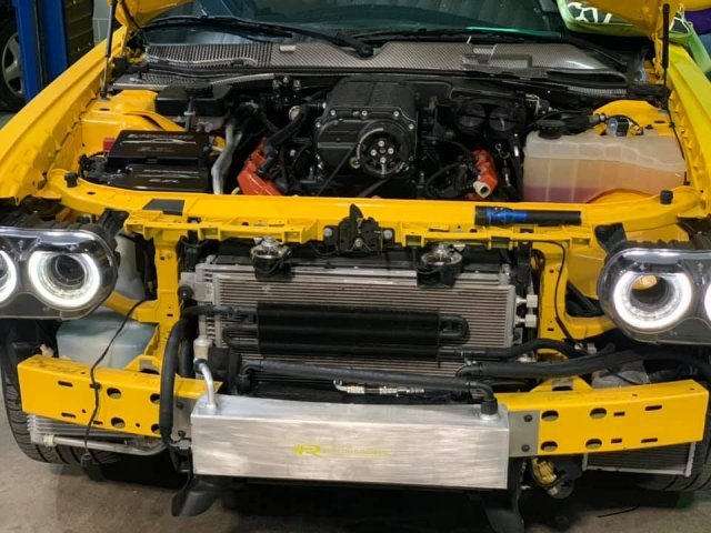

Just grabbed a Killer Chiller race drag system to cure IAT/Coolant temps. Not sure about adding the bigger reservoir. Might see how temps look before deciding if one is needed- unless ya'll that have one on a 4.5L know better.

View attachment 25043 View attachment 25044
View attachment 25041 View attachment 25045
Highly recommend adding a reservoir, 1.5 - 2 gallons is ideal for 1/4 mile.

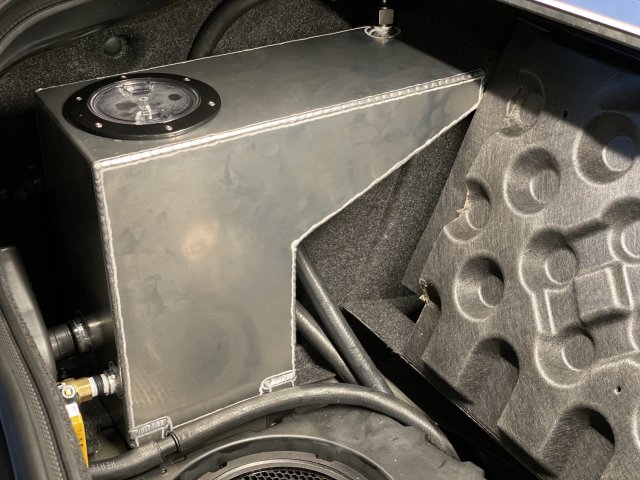

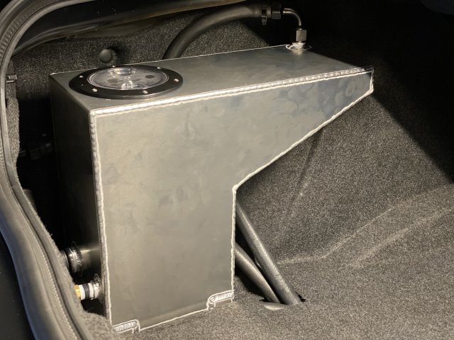

Agree. I went this route because with the shape of this tank, I can run that 2 gallons without uncovering the pump intake and I have the option of still using ice at the track. 72F19AA2-6F5F-4309-A895-EC6AEF1011C1.jpeg

I run a 2 gallon Gearhead tank in the front bumper. For $300 bucks it’s a great fit

Thanks ya'll. Going to add the coolant tank made by Gearheadfab then.

That picture is of the “inter chiller” system from florida, which works worth dick. The gearhead tank sits flush between the front bumper support, it’s slick.
Glad i went with the killer chiller system, never heard back from that guy in Florida. FI Interchiller would probably be a better option but wanted to stick with a US manufacturer.
Do you happen to have any pictures of the gearhead tank setup?

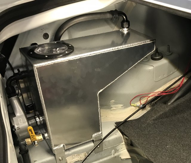

Yes 665DDE57-1429-4E20-A4AD-1F27F6936FB8.jpeg B0B8DC19-3FA0-4F60-81D4-074F4177725E.jpeg 88B32CA3-E0D0-49FE-A163-54D4131EB99A.jpeg

Thanks for the photos FFBOS.

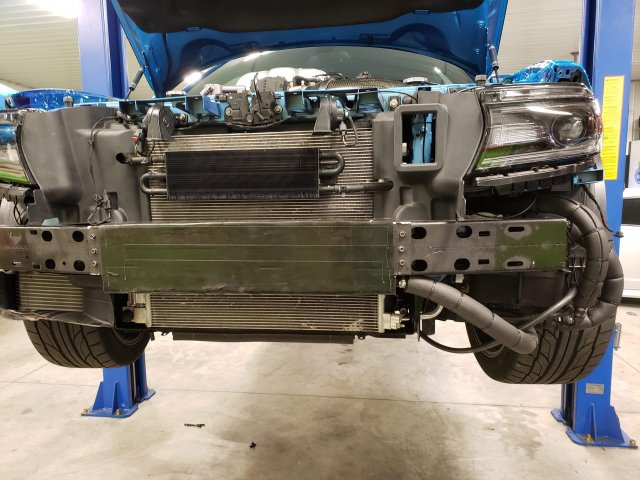

Wondering if the 13" 'race drag' version will fit in the same location. Going to check what the shop wants to do before ordering the Gearheadfab tank.

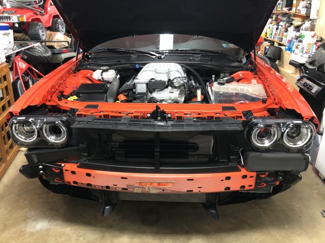

I like how 16GoManGoHC mounted the 14" chiller under the driverside light. Also made a custom 1.5 gal reservoir to go under the passenger side. Very clean install.

Chiller is the best bet for street and strip hands down.
The 13” should fit same location

From an engineering standpoint i like the chiller concept much better than an Icebox. Both will do the job. I wouldn't call it a band-aid to an ice-box though.
With a chiller you don't have to remove the sound system from the rear (Street car life haha) - No need to fill up with ice packs or dry ice before racing on top of that.
The demon/redeye have a SRT Power Chiller™ from factory. The OEM Engineers must have came to the conclusion it's a quality system. The 2021 Drag Pak is still using an Icebox setup -> those cars don't have an A/C system to begin with for weight savings anyway. For a Street warrior car the chiller is perfect, for MAX-effort removing the A/C system is the most competitive. Comes down to your end goals with the car. Plenty of 8 second cats with the factory A/C system in place. That's all i'd ever want out of this journey. Chasing any faster will put me in the poor house :poop::ROFLMAO:

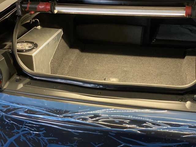

Check this out. Custom install by SRT AutoWorks.
We can load this bad boy up with lots of ice.
No need to remove sound system with this set up.
Easy to fill up too
4F4EFF5A-83AC-4061-9FAF-63AF0232529C.jpeg C1B1ECC9-7FBB-4B38-96CD-3106E108A7E3.jpeg 56EC364E-0A39-4BE0-8B75-2B5CBCB4BCF7.jpeg
