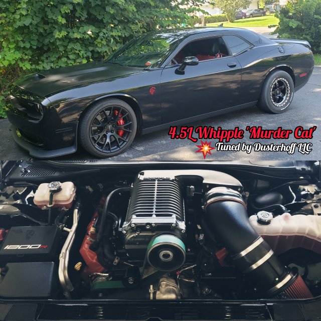

Currently in the process of finishing tuning on my Hellcat project. Been quite a process over the past year, motivated to see it complete now before winter hits again up north!
Huge thanks to 'Whip Cat' - 'SRT Stinkeye' and other whipple owners who've done a lot of R&D over the past few years.
Loving the car so far after about 1500 miles of seat time data logging. Night and day difference vs. Stock. First 60-130 hit was like a roller coaster :D
Car will have a flex 93/E85 map on the 5" pulley and one on E85 only with the 4.5". Dyno results will be posted once finished.
Mods:
Engine:
Stock 6.2L/Heads (For this season, plan to upgrade to a 426)
4.5L Whipple Supercharger
Killer Chiller Race Drag System
Coolant Expansion Tank
Fore Innovations Dual Pump Fuel System w/Rails
FIC 1650cc PnP injectors
Magnaflow Catback
180 Degree Thermostat
ER12S Spark Plugs
Demon Crank Bolt+Double Pinned
Dusterhoff tuning with HP Tuner Software
Brakes/Wheels/Tires/Suspension/Drivetrain:
DSS 3.8" Carbon Driveshaft
DSS 1400HP Axles
Per4mance DIRS Brace
Bwoody Rear End Links
Z26 Powerstop Pads
17x10 18x5 Beadlock Drag Pack
MT ET Street R 305/45/17 28x6x18 Sportsman Runners
Titanium Lug nuts
Exterior & Interior:
SRT Performance Spoiler
Speedtactics Fire Extinguisher kit

Thanks for the welcome and advice!
Was told by Dusterhoff tuning the 4.5" was safe for this setup @ 21psi. 4.25" was when recommended to build the motor.
Definitely won't be running higher boost often on the stock rods. If ever ran will be going for a personal best in the 1/4 or 1/2 mile.
Very happy where the car is at now. The 5" @ 16psi is perfect for the street. Almost a dead hook from 40 on 17" beadlocks w/ET Street R. Can definitely see needing a 15" conversion with the 4.5" or smaller. Problem is that setup would scare a LOT of local racers off when they see the huge tire. :p Going to see what is possible on 17s/stock block before getting crazy. Believe the 'Omega' car did 8's on them.
As for fuel sticking with pump gas (93/E85) When built will shoot for 1100-1200whp. Not going for any records, trying to keep everything together like the rest of my builds over the years. (Not one blown motor/turbo etc. I drive the cars HARD) testament to quality tuning/not buying china parts. In the end the goal was a 1000whp street car, anything more is a bonus.
Currently stuck on the flex map - Seems to break up a bit rolling into WOT 30-50mph. Still a few gremlins drive-ability wise.
40 hit:
